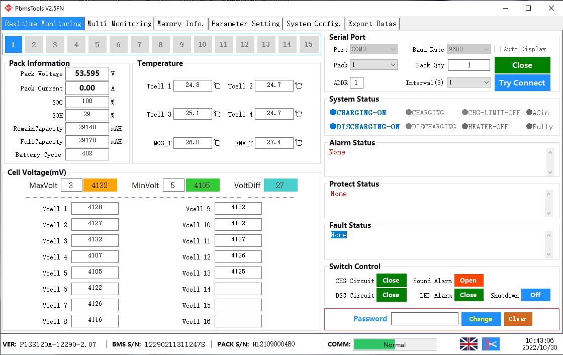

My battery is still fine after ~170 cycles, but PBMSTools shows I'm on FW 1.43 (P13S120A-12290-1.43), so I want to do a pro-active update.
I think there's at least a FW 1.50 available, according to this screenshot here:
@swazz99jhb

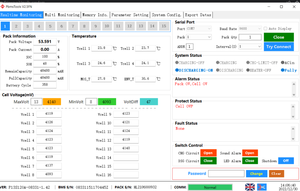

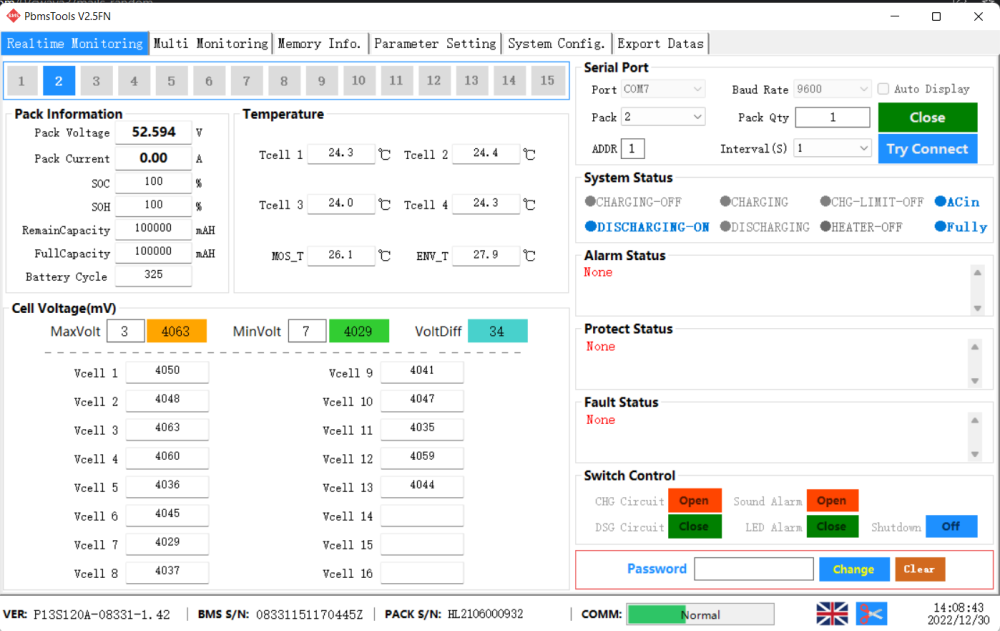

So i got the USB- RS232 cable from SA. PBMSTools shows the following.
My RIOT reports SOH of 78%
If i look at the PBMSTools info am i correct in saying there is an issue with battery no 1?
Battery 1 was installed in Dec 2021 and batttery no 2 was installed in Feb or March of 2022.
Where to from here?
Your full capacity on batt 1 is the problem at 48. See 2nd is 100 which is correct. Same problem I had. The can fix it in Jhb or Cape Town
1 hour ago, WAP said:
Battery 1 was installed in Dec 2021 and battery no 2 was installed in Feb or March of 2022.
Does PBMS tools only read the primary battery info?
Your two battery screenshots both show the same Ver:  BMS S/N and Pack S/N at the bottom.

Looking at @WAP second battery pack which is supposedly 100% SOH, the battery Voltage is just about 52,6V but the cell voltages are not even close to 4,2V, being in the range of 4,029V - 4,063.
Then looking at the "problematic" pack 1, the cell voltages are 4,093 - 4,140V, much closer to the 4,2V max. The pack voltage is 53,6V which is the exact voltage for bulk on both the label and their site, yet this battery reports only 48A/h.
With values like this one can only guess that there is a problem in the data interpretation. Whether that is caused by the BMS firmware, Inverter Firmware or a combination of the two remains a mystery.
Yes, there is. It has gone in to cell over voltage protection and there is also a pack over voltage alarm which means your battery charge voltage was too high. It could be that you have 1 or 2 cells that are charging faster than others, it would be interesting to see what these screens look like while the batteries are still charging.

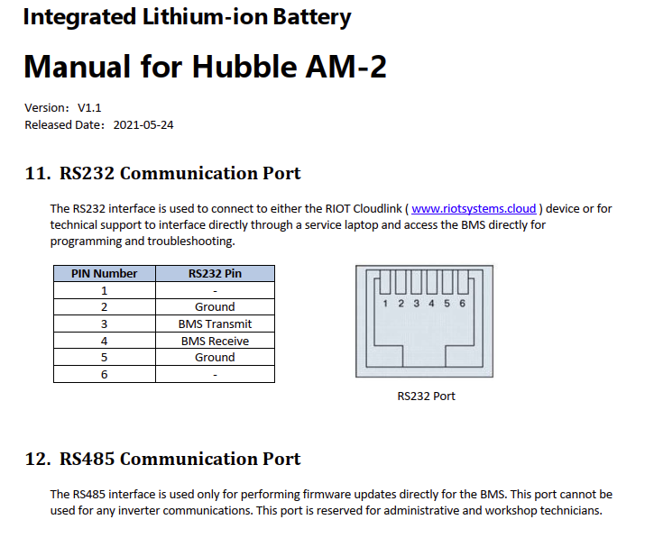

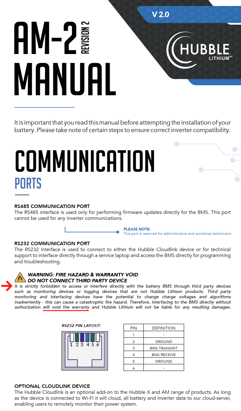

The version 1.1 manual released 2021-05-24 for the AM-2
Version 2 Manual has a clause added.
This is sad as it an attempt by Hubble to keep vital information hidden from their customers.
RIOT over the 2 years that I've had it has removed SoH and other useful information.
My battery is still the Version 1, so not sure if this clause applies to me.
