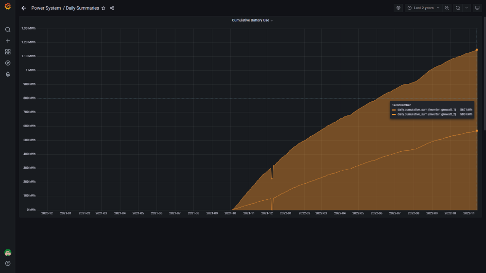

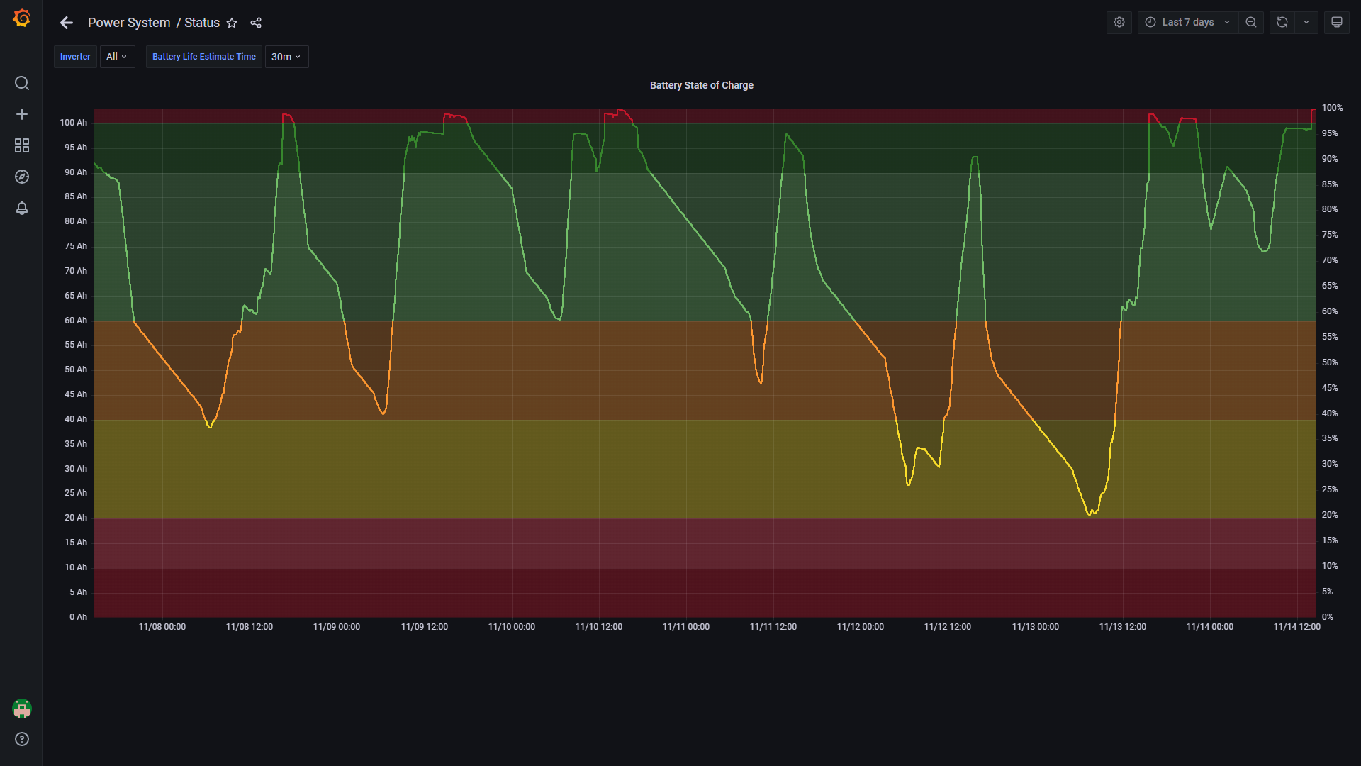

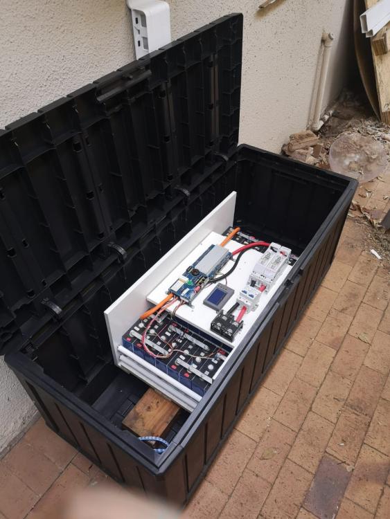

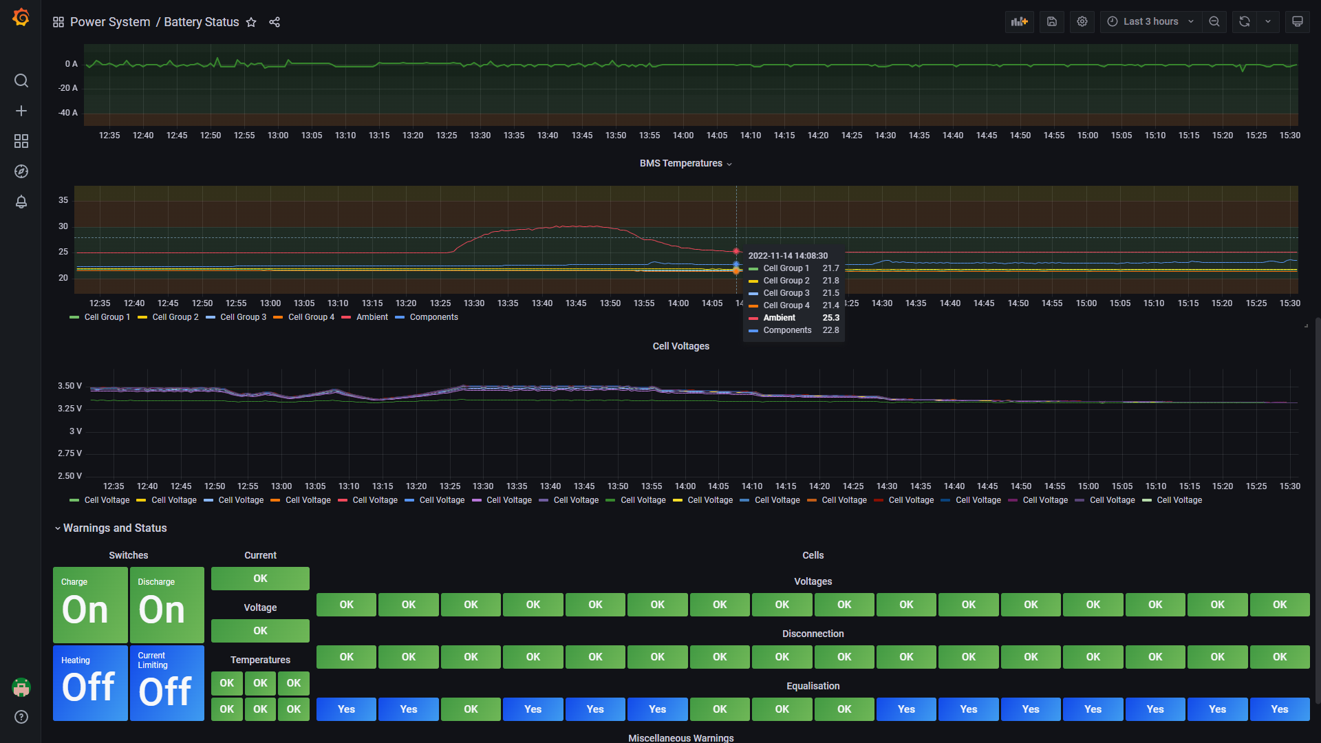

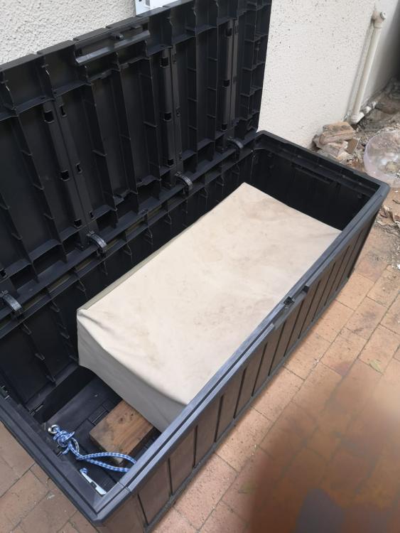

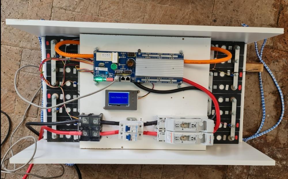

I built a 10kWh DIY battery in December 2021 with locally bought 100Ah cells together with a JBD BMS (250mA balancing), compression rods and wooden box. I have SMA Sunny Island (2013 model) inverter and did not need comms between inverter and BMS as I am used to using voltage settings. Up to now the cell imbalance was never more than 40mV and usually below 15mV. I used the Bluetooth App of BMS to monitor the cells as and when required.
After this positive DIY experience, I bought EVE LF280K cells via Alibaba and also some Seplos Mason 280 DIY boxes. I installed my first box a month ago and up to now found the cell balancing very good (below 10mV imbalance). Planning on building a few more.
I posted some pictures and also modifications here of my first Mason 280 DIY battery build.
I was so impressed with the Seplos BMS, that I upgraded the first DIY battery to use the same BMS. See attached photos. My son is busy designing enclosure to 3D print for the BMS together with the LCD.

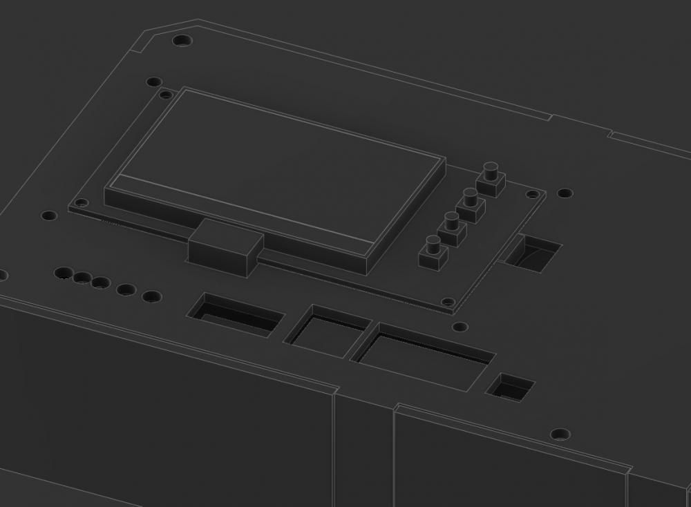

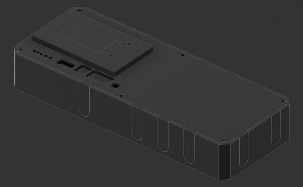

The 3D design for the Seplos BMS is complete and available at https://www.thingiverse.com/thing:5604549
For more information see here

Hello DeonBez,
the Box for the Seplos is so great, i love it.

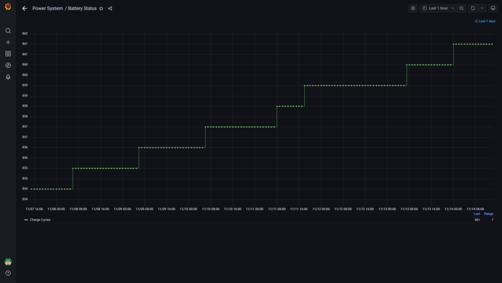

Thanks for the info, as you can see from my dashboard my battery only once as gone to 20% SOC this all week, yet it counted 7 cycles.
So the count setting must be set at 20% as default from the factory.
Many thanks I will try change that specific parameter.

@Patrick OReilly Seplos BMS as far I'm concerned is an excellent BMS you do not need an external balancer, it does that by itself, once cells reach 3,5 C starts to balance.
I get all info from my BMS and one can clearly see it does that. See dashboard. My battery has a problem cell it does not get to full voltage. image.thumb.png.00de8696f92dd5d701aaac6b4a88973f.png

It is both Patrick,
it is like a hobby and i save a lot of money. If you build your own 280Ah Battery with 48 V you are less than 2.700$, if you buy a case also you have 3000$ for a lot of power, make a double and you have enought.  (28kWh /6000$€) If something went wrong, you can fix it, because you built it and know how it work.  Also you are more sensible by using power, here in Europa nothing is normal anymore, no more culture and respect. All crazy here. We will become a energy problem here if the green party and klimachange stupid is not over in a few month. The price for Energy rises and is double in one year, so thinks change fast . I like to be my own master and not say to the govement, please help me. The only they do is to rob you more . But it is also ok to buy a battery from company and have no problems if you use them normal. (80 % cost, 20 % hobby)

Mine is doing the same Counts one cycle even with only 16 % used How do you change the settings? If I just keep it like this would it negatively affect the batteries? I know it would appear much older/ used just because of the high cycle count
@Antonio de Sa I vaguely recall that the cycle count is set so that if it goes down past 20% DoD (80%SoC), it will count a cycle when it starts charging again. I also remember something about an extra cycle being counted if you go past 80% DoD. I would not really worry about the cycle count per se, I look at total kWh out and divide that by 80% of the capacity.
@P1000  You are correct, that is exactly how my system behaves. Presently with just over 1 year of use my battery supplied 1,148 MW/H of power, (see Dashboard) it has counted 862 cycles.
You say I should not worry too much about the cycle, OK it just looking at the cycle count it looks like this battery is much older.
Mine is doing the same - Count a cycle for every discharge LBSA not giving me a proper answer or a solution ? Not sure if i will be able to get into the BMS and correct the settings and itf it will affect my warrenty?

I've been monitoring my battery for over a year now, since I started, I can clearly see that there is a bad cell in the pack. Contacted then they told me to bring the battery over and they will fix it. Now the question is, with the state of continuous daily load shedding I cannot afford to be without a battery for a few days, I have no choice but to run it like that.  Now regarding the cycle count it can be fixed using the Seplos software, but if I was you, I would contact LBSA and ask for permission to do it, or better ask then to do it for you, that's presuming they know how to do it.... may affect the warranty.
Maybee you should take a look at seplos BMS menue
Point 81 maybe, test it or ask seplos
