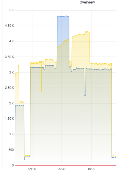

I have a 150l with 3kW element and even when my water is down to 30C it takes max 1:30 to get it to the max Geyserwise temp of 65C. So I could easily heat a second geyser to that temp too. All dependent on the size of the Inverter and panels obviously and of course the solar irradiance on the day.
Today my geyser was at 31C and you can see the 3kW element starting at 08:58 and switching off at 10:20. So I could have heated another one from 10:20 to 11:50.
