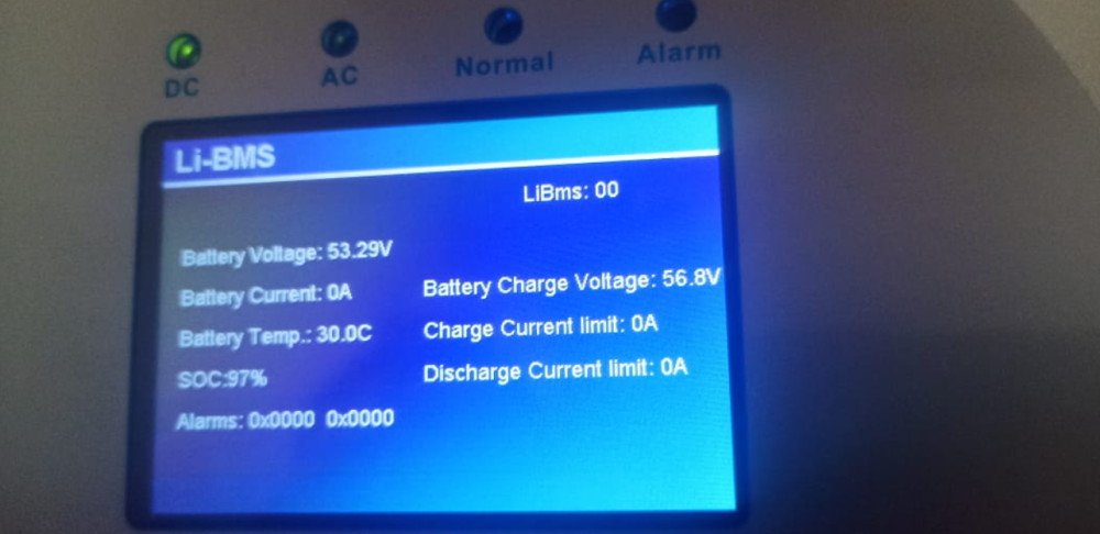

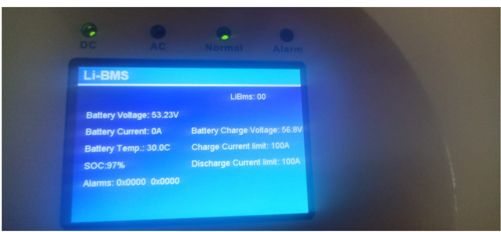

December 12, 20241 yr Hi All I have deye 5kv hybrid inverter and Volta stage1 battery setup , When the battery reaches 100 % and I switch off eskom power to run on the battery the electricity switches off when trying to run the battery. I noticed the following: While Charging BMS shows the battery info @97% The BMS info @ 100% Please can I get assistance to sort this out or did anyone else experience this.
December 12, 20241 yr 15 minutes ago, ZUbair1710 said: The charge current limit and Discharge current limit disappears . Good point and the Normal light has gone off as well. You could possibly try running the battery in percentage(%) mode instead of lithium mode. It is on the battery screen. Another thing you can try is to disconnect the comms cable between the battery and inverter to check if the battery is sending bad info to the inverter. If the battery is ok, the inverter should be able to use the batteries quite easily without the comms cable. Should be a good experiment.

January 7, 20251 yr On 2024/12/12 at 8:13 AM, ZUbair1710 said: Hi All I have deye 5kv hybrid inverter and Volta stage1 battery setup , When the battery reaches 100 % and I switch off eskom power to run on the battery the electricity switches off when trying to run the battery. I noticed the following: While Charging BMS shows the battery info @97% The BMS info @ 100% Please can I get assistance to sort this out or did anyone else experience this. If your Discharge current limit drops to 0A you effectively cant draw anything from the battery as this is what the BMS is telling the Inverter it can and cant do . Discharge current limit should only ever be effected when the battery SOC falls below 15% .. Prevents High discharge from taking place on an empty battery ( cells at low soc can fall off the discharge curve easily ) It doesnt drop to 0A until the battery is empty at 0-5% SOC . So this is weird for a battery with a 97% SOC..
