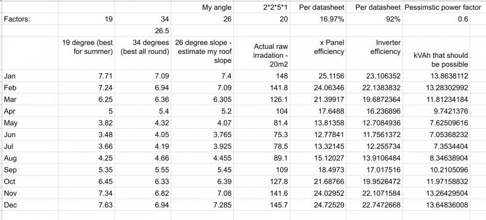

So I did an attempt to calculate the possible production for 10 330W panels at my house in Cape Town.
I started with solar insolation stats from the site - http://solarelectricityhandbook.com/solar-calculator.html
I then factored in the angle of my panels, the efficiency of the various steps and came up with this:
https://docs.google.com/spreadsheets/d/1LyiPxAJl0FcZ7htSgYBEwErdAKaaLO1zrc2gkk1EnOI/edit?usp=sharing
How does this look compared to practical experience?
The power factor I guess is a big thing in terms of the power - I used 0.6 which is pessimistic but I saw somewhere that is a figure that is used.
If these numbers are right then the real challenge is to use all that you generate at the times it is available?
