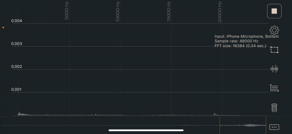

Here are some spectrum captures to show it from my mobile:
- One right next to the inverter
- One In a bathroom with door closed (silent for baseline)
- One in the my office with my laptop and Monitor
I feel like I can hear the noise even if very soft but I could just be paranoid now.
Next to Inverter
Office
Baseline
Edited by PRP
