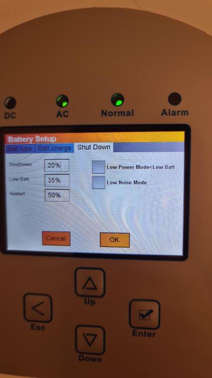

    I must correct myself. After updating to version 3384, a new option appeared. Settings -> Battery -> Page 2 -> Low Noise mode Enabling this setting shuts the inverter down, "Grid Mode

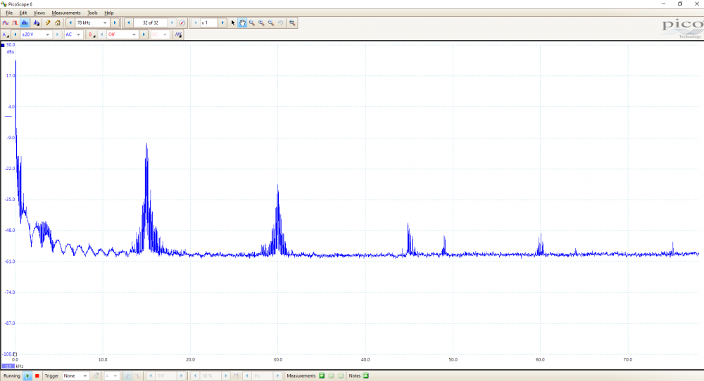

I have a 5kW Deye that I installed about two years ago. Same internals as the Sunsynk. I could never hear the high pitched noise, but Eskom recently installed split-prepaid meters which use powerline communication (G3-PLC operates on the powerline at 35KHz to 95KHz) to connect the keypad in your house to the actual meter outside in the street, I did some investigating. The noise the inverter creates is so bad that it actually prevents not just my keypad from communicating, but everyone else on the same phase as me while the inverter is connected to the grid.
There is a significant peak at 15KHz which is in the audible rand and is the high-pitched noise everyone is hearing. The inverter also creates harmonics a few orders down, meaning that every 15KHz there is a peak. I am seriously questioning the inverter's NRS certfication which requires harmonics to be with a reasonable range and interoperation with other main signalling devices (such as the Eskom prepaid meter).
Attached is a frequency domain analysis on the powerline with the inverter on. You can clearly see the harmonics at every 15KHz. Also attached is a frequency analysis in the audible range showing a peak at 15KHz. This was taken in my kitchen where there are no appliances or audio devices that produce sound.
I contacted the manufacturer regarding the issue and their response after upgrading the firmware was to buy a powerline filter. This shouldn't be necessary if the filtering in the inverter is adequate. Once again, no idea how they achieved NRS certification.

Firstly, I think the switching frequency of the output changed after NRS certification (from arount 19kHz to 15kHz) - which should IMO nullify the current certification. Apart from that, there does not seem to be a hard limit on the harmonics produced, except for the THD which is as a percentage of the output power. I'm sure the 15kHz peak you see does not affect that measurement much. I personally would not buy an inverter with a switching frequency less than 20kHz.

I can guarantee that the correct filter will solve this issue (but it will be rather large and I have not seen an off-the-shelf solution). The correct filter should have been installed in the inverter but clearly is not.
Just for clarity - a common mode filter will not work, as this is not common mode noise - pretty much all of it will be passed through a common mode filter.
