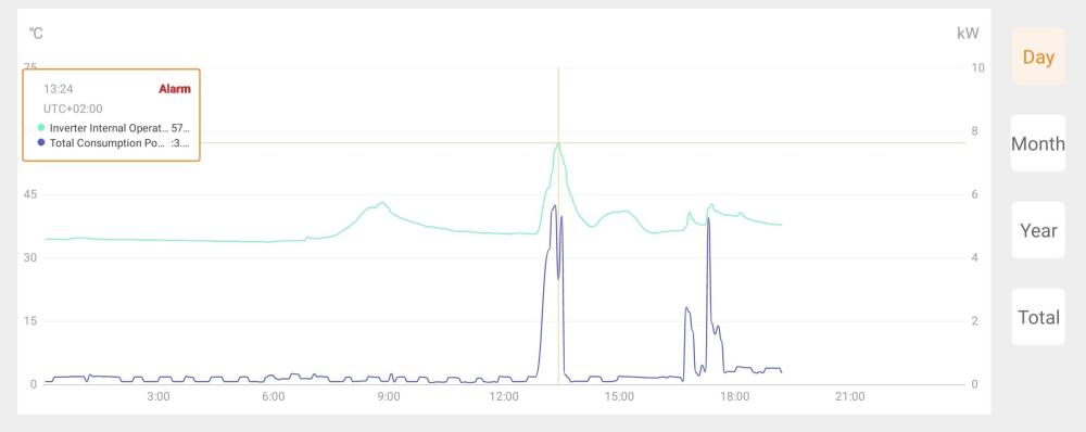

Which brings me directly to my first notable issue I have with this inverter. As per the Goodwe, it’s missing a Sunsynk-like time-of-day multi-minimum SoC setting operational mode. It has quite a few operational modes, but those that do, only allow the definition of charge and discharge times and power, just like the Goodwe. Maybe this makes sense when using Time of Use tariffs, but otherwise just seems unnecessarily befuddling and complex for the average person. You can however set one reserve SoC per mode, which will tell the inverter when to stop discharging the battery, but this is not as flexible and useful as the Sunsynk SoC timer where setting different SoC values depending on the time of day is possible.
Also, as seems standard in the inverter industry, there are a multitude of settings that have no reference in the manual, probably due to newer firmware releases since the manual was published, but descriptions for many settings are simply not defined anywhere – videos, the Solis website or otherwise. Making setting available without proper documentation for installers or end-users is just poor practice, but again, even Sunsynk is guilty of this habit.
Thus far, after about two weeks, the inverter has worked flawlessly, without issue. In my home, I typically run all essential and non-essential loads off the inverter, so this includes running a 3kW geyser, electric stove and two inverter-type air conditioners. Of course, not everything runs at the same time and some load management is still required, but the extra 1.5 kw headroom over the 4.6 kW Goodwe is certainly appreciated. I have also noticed the inverter seems to run noticeably cooler than a Sunsynk 5 kW, as well my previous Goodwe, with the heatsink only getting noticeably warm after running the geyser for its daily Geyserwise-controlled cycle. The inverter does appear to have an internal fan, like a Sunsynk but quieter, and I’ve only heard it turn on once when my CT-issues caused it to export 6 kW to the grid. Plotting the internal inverter temperature on the SolisCloud app shows the inverter internal temperature has not gone above 48 C yet, with the inverter being mounted in a ventilated cupboard.

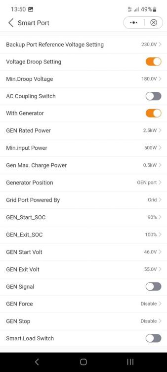

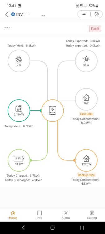

As for the generator integration, I did a test earlier with a small 3.5kw generator with a variable throttle (left on for these tests) which worked without issue. Note that I'm using app v4.05 and my inverter firmware is v0501 for the DSP and HMI is v0901 seen when connecting locally. If your firmware is older, I'd probably contact Solis support to update it.
Here are the settings I used to test the gen (connected locally via Bluetooth):
Main things I noticed are:
- The inverter behaves essentially like a Sunsynk inverter - it will switch all the loads and battery charging onto the generator so make sure the generator is large enough to handle what you have configure plus some loads (or turn all the loads off 😀).
- If the loads are larger than the GEN rated power setting, the inverter will not attempt to connect the generator.
With regards to the settings:
- I presume the voltage droop enforces a minimum voltage on the gen input - if it drops below this value, the inverter will not engage the generator or will disconnect it.
- AC Coupling should be off - strange that the app allows you to enable this along with the With Generator setting but it should be off.
- Couldn't figure out what Min input power does - thought it might relate to the minimum load that has to be present before the inverter will use the generator but that didn't seem to be the case.
- Gen Max Charge power sets how much of the generator power goes to charging the batteries. This setting is very generator friendly as the inverter ramps up the load so as not to make the generator frequency drop and get disconnected.
- The GEN_Start_SOC is the level which the battery has to be below before the inverter will consider using the generator. GEN_Exit_SOC is the SoC where the inverter will disconnect/shutdown the generator.
- Gen Start/Exit Voltages are presumably used if you are just using battery voltages instead of SoC via BMS, so in most cases, these won't need to be changed.
- Gen signal would be used if you want to use the inverter contact to auto start a generator that has a controller or support for remote start signalling.
- Gen force usually forces the inverter to use the gen input, regardless of the other configured conditions. I didn't test this function but presume it's the same as the settings on a Sunsynk/Deye.
- Gen Stop on my app can't be enabled but maybe it's a toggle - perhaps one can manually force the start signal contact to open and thus stop the generator.
- Smart Load Switch - not sure how this could be enabled if With Generator or AC Coupling is enabled - seems like only one of these should be possible to enable at once.
Note, there are no frequency tolerance adjustments here. I presume the inverter uses the same frequency tolerances on the gen port as the grid settings so one might have to adjust those, especially the lower end side if the inverter switches in the generator but then tends to kick it out immediately as a load is turned on and the frequency drops too low. You can find the frequencies under Grid Code Setting ->Grid Code Parameters. I believe the ones of interest are the Startup/Recover FH/FL settings near the bottom of the list. I didn't have to adjust mine for charging the battery and turning on an inverter-type aircon, but the inverter chucked the generator off when I turned on a 1.2kw hob plate. That is often also related to the use of the dynamic throttle on the generator which sometimes isn't fast enough to respond.
It would be diagnostically useful for Solis to add some real-time details to the generator info section that shows the current generator input frequency (and voltage, if it's not there, can't recall now as it doesn't show up if the generator is not connected).

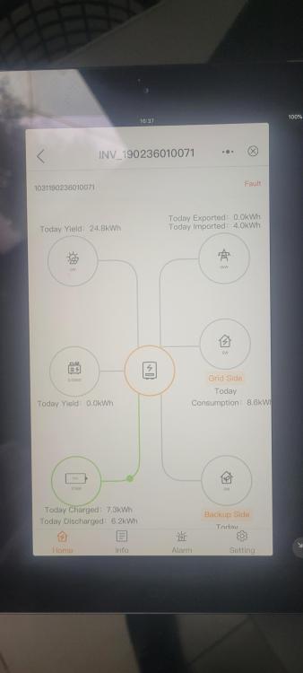

Here's a screenshot of the power flow with the generator working:

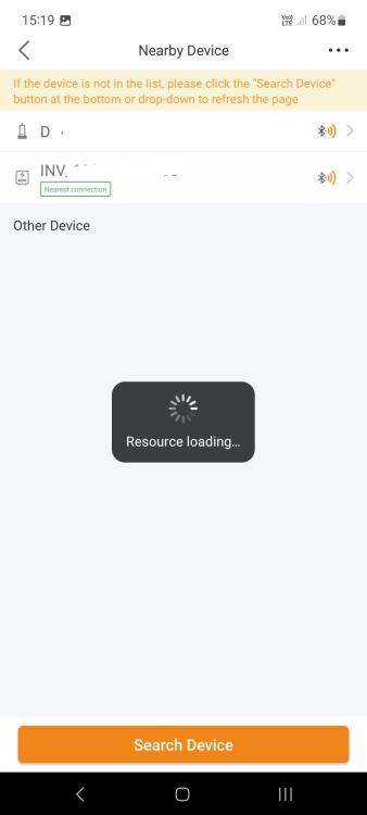

- There is an interesting issue with the Solis app where if you have no Internet access, you can't seem to connect to the device locally to configure it. I tried a few times of restarting the app and waiting a fair while but it gets stuck on the screen below. Easy enough to get around with a mobile data connection via your phone, but still somewhat bizarre to require an Internet connection to perform local Bluetooth configuration.

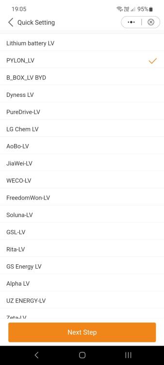

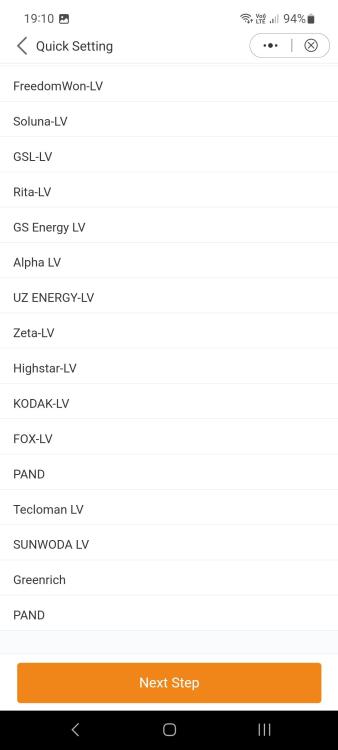

- The inverter is currently connected to Pylontech batteries and I wanted to test it with a Greenrich battery, which I have been told by Greenrich is compatible the Pylontech BMS protocol. As I didn't see it listed in the settings area for batteries, I simply left the inverter in the Pylontech setting and the BMS worked perfectly with the greenrich battery. However, the inverter didn't want to enable the load output and on investigation I could see there was some strange bus voltage alarm. After reviewing the battery parameters displayed by the inverter, I could see the high voltage charge protection value I had previously set to 53v for the Pylontech was probably the issue as the Greenrich was already above that value. However, I could not find the setting anywhere in the settings menu indicating it was probably removed at some point. I eventually ran the Quick Setup again which actually has a much longer list of supported batteries (including Greenrich) than the settings menu where I was looking. Here's the current list. I suspect Hubble batteries will also work with the Pylontech setting.
