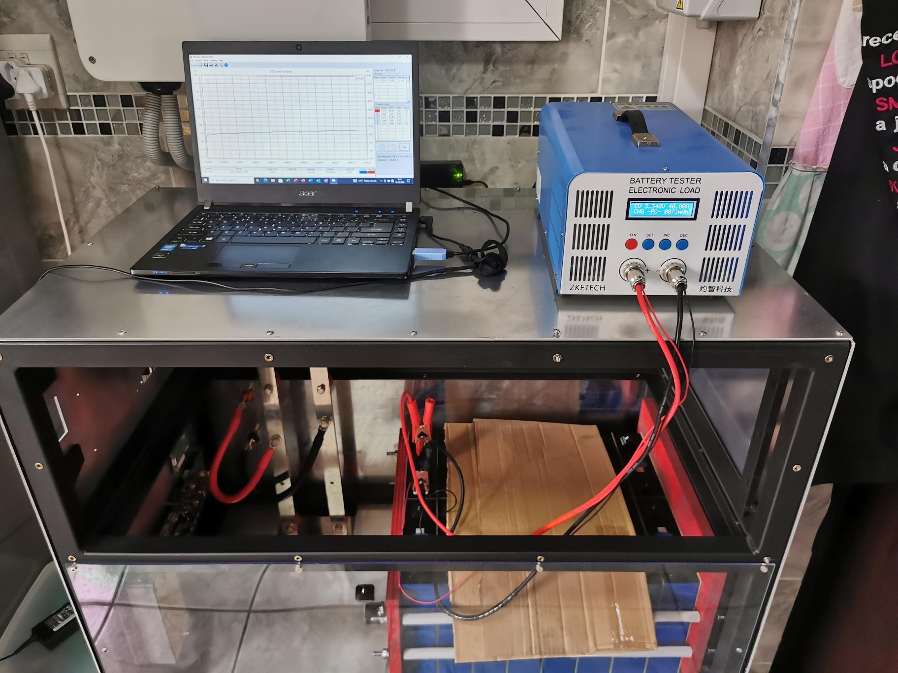

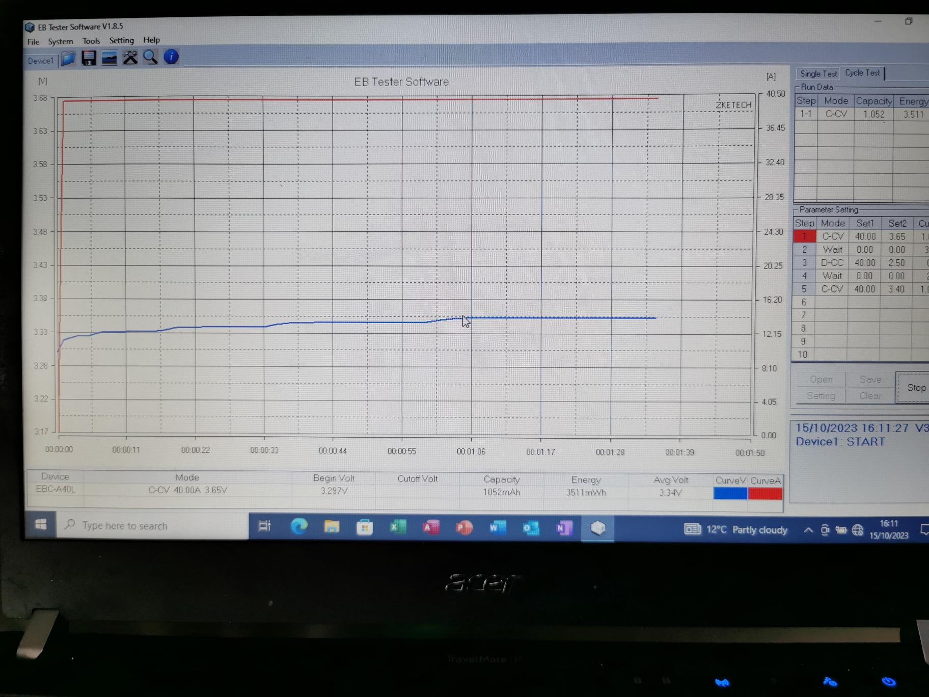

October 12, 20232 yr Received my cells yesterday. They look great. Not a single mark. Definitely grade A. I was surprised that they even included 4 pieces of seperation material in each box. Will begin capacity testing next week.
