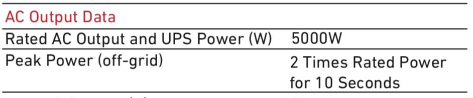

December 1, 20232 yr The 5kw can do 8kw pass through total with grid present. You absolutely did not overload it

December 1, 20232 yr 7 hours ago, kripstoe said: More details. I don't understand why this would have been an issue? If the load is higher than 5000W, then surely that would have been supplied by the grid? The inverter should supply up to a max of 5k, and the grid the rest. We're not talking thousands of watts here. We're talking less then 500w.... The rated output from Ac & UPS power according to that data sheet I've posted says 5,000w so if your load as shown was at 5,107w your alarm should have been going off, unless it was switched off. Did the alarm go off? The inverter is also touted to have "Output Over Current Protection - Integrated", which means it should have just shut off and not got damaged unless there was an in-rush of load and the protection systems, other than the inverter put by the Installer are inadequate which makes the installer liable, in my view. Do you have a schematic from your installer or photos of your installation for us to see the installation setup?

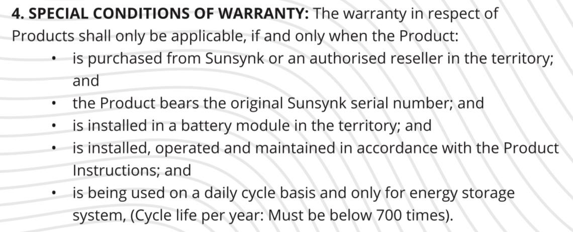

December 2, 20232 yr @Steve87 If product is bought from an authorised reseller but installed by a non-sunsynk approved installer, I take it, well it clearly means if there's an issue Sunsynk can worm out of honouring warranty right?

December 3, 20232 yr @kripstoe it would be interesting for me to ask you to qualify when you say, "It's a professional install", is your installer a Sunsynk Authorised installer or this is an installer recommended to you by others or one you got through various searches?
December 3, 20232 yr From my experience some even so called sunsynk master installers do a shoddy job and the CoC isn't worth the paper it's written on. So I would say get an independent 3rd party to assess your install. If in jhb Mr Steve87 would be happy to help.
