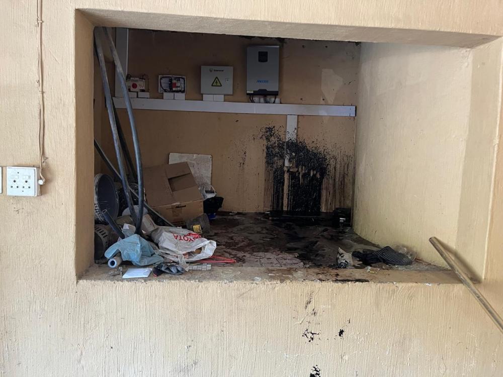

42 minutes ago, madness_za said:
Well it was bound to happen. Batteries in the neighborhood started to burn and this has set off panic in the community WhatsApp group. My money is on a poor install and lack of battery monitoring but who knows…
Well I think I don't see any disconnect between the inverter and the battery, but would they have stopped a fire? That would only trip/pop if there was excessive current draw.
Does look like a job that is done down to a price rather than up to a specification, but if a battery is going to pop then what's to stop that happening?
Thinking about the certification I did with the City of Johannesburg, they were not the least bit interested in fire extinguishers and such. But then a COC doesn't say that your house will not catch fire, just that the wiring meets the relevant standards.

@Deeos you have, I believe NMC based Lithium batteries, these can and do potentially start a fire, see various scenarios where Electric cars burnt out. Most stationary energy storage based Lithium batteries use LiFePO4 cells, no Cobalt or Manganese and I have yet to come across a report where these caught alight for whatever reason, but the NMC types, plenty of examples out there.
@madness_za the battery involved in the fire, any idea what it was? and curious where this happened?
Florida/Bergbron area, and I have no idea as to the specific make of batteries
I wonder whether the "cave" where the battery and inverter were located were open to the outside, or not... low temperatures can be problematic, more so in NMC cells, but even LiFePO4's probably wouldn't be happy with close to freezing/below freezing temperatures, but I doubt LiFePO4's would display their displeasure by making a fire to get slightly higher temperatures...
