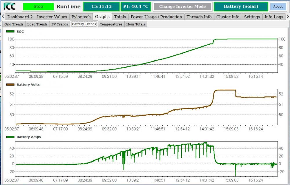

11 hours ago, wolfandy said:
In my view the Axpert's inaccurate voltage measurement does not allow you to take full advantage of the capacity of the Pylon (without at the same time running the risk of depleting it below 20% and impacting lifespan).
I think @Anish also mentioned before that he is struggling to close to get full capacity out of his Lithiums as his inverter cannot use the BMS data as therefore switches prematurely using only overall battery voltage. I think he has 9.6kWh can use about 6kWh (don't quote me).
You'd like to avoid the position where you paid for a 3.5kWh Lithium and can only really use say 2.2kWh, instead of the 2.8kWh you'd get on 80% DoD. However, if you overspecced on the battery capacity, I guess you'd get a long life out of it if you manage it like that, but you should just be aware of that.
Obviously the battery's BMS is still only guessing, but it has MUCH more information available to it. All the internal cells' voltages etc.

19 hours ago, wolfandy said:
This is the info that ICC displays
This is very cool data. Is there any spec available for the communications protocol?
