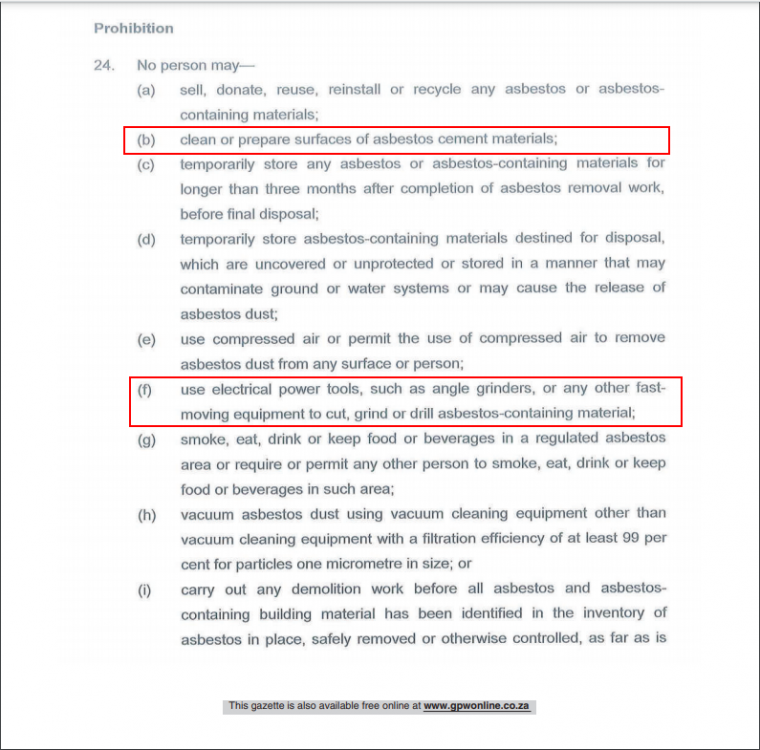

My house has an asbestos roof (like thousands of other houses, schools, hospitals, etc.) and I got Wilcote in to refurbish it 4 years ago. I was told that it would now last for a very long time and their products have a 10 year guarantee.
Well, the paint has thinned and lichen is growing through. I emailed pictures and called them and now they say that the government changed the asbestos regulations in NOV 2020 and they can no longer clean or prepare the roof. Government is trying to eradicate it.
I said it looks like they didn't clean and prepare it properly and what happens now with the 10 year guarantee. He chuckled and said that there was no way, at that time, of them knowing the regulations would change and that they are not allowed to clean or prep so there isn't anything they can do. It might require a new roof.
So I have to decide if I want to attempt another encapsulation process with a different company (that has a license for the new regulations) or replace the whole dam thing. 160m2. It is going to be dam expensive. Sigh.

The guys were allowed clean and prep back in 2017. I got quotes from 3 large independent licensed asbestos contractors back then. Wilcote are (maybe WAS now with new regulations) a national asbestos contractor.
Asbestos Abatement Regulations - 10 November 2020 No. 43893 - These regulations repealed the 2001 regulations.
You can / should apply for exemptions from these rules as they (probably) apply to uncovered roofs.
We used to apply for exemptions all the time in the mining industry. It is all about risk management.
Your ex contractors know this and are escaping their responsibilities.
Find out who the environmental inspector for your area is and make an appointment. Greenies are kindhearted people.

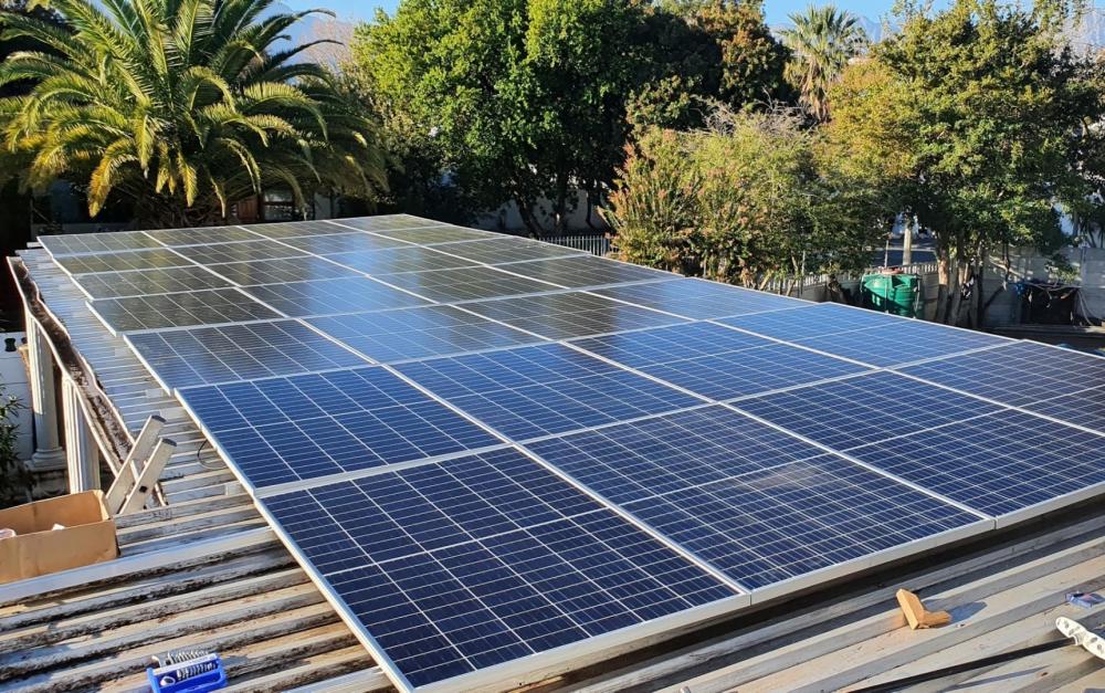

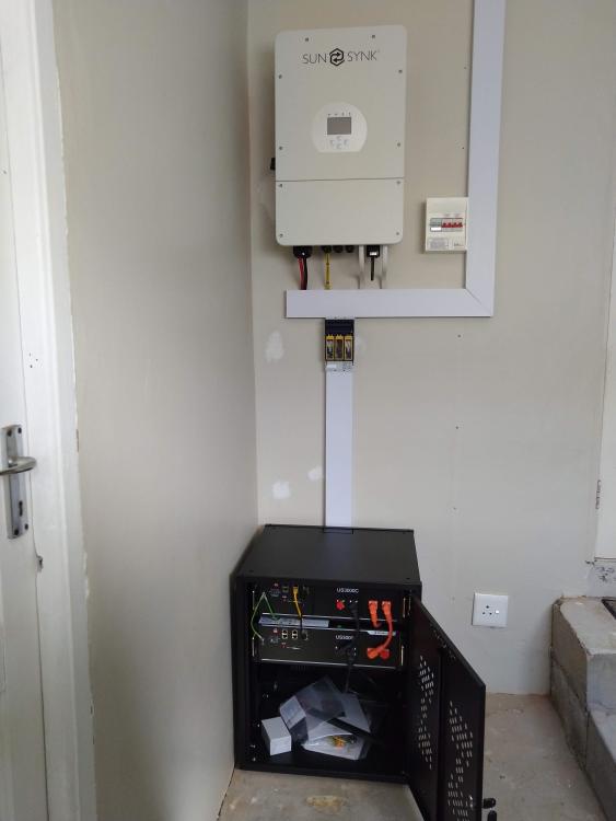

So I'm up and running. 🥳
8kw Sunsynk + 2 x US3000C + 7 x 455w JA Solar Mono (single string on the main roof facing NW). The other 7 panels are going on a new structure facing NE - but awaiting design from architect.
I've been trying to read all the info about the Pylons on this forum, and it is a lot to take in and understand. ,
1.)  Charge Amps are set to 40A and should be 74A?
2.) Float V looks higher than all the discussions I found on search (e.g. from @Coulomb @Vassen) . My understanding is it should be lower?
3.) Are the Absorption V and Equalization V correct?
4.) The Battery Voltage at 100% SOC was only 51.48V.

Nice.
First thing you should do is request an update if you are not yet on the latest version.
You don't need to bother with 1 to 4 as the BMS overrides the settings in the invert.
On the first pic it does that the BMS is limiting charge and discharge currents.
Welcome to the sunsynk club.
That's a cool install, congratulations. Agreed with @vassen on the separation of AC and DC circuits though.
The pics are never complete if we do not get to see the solar panels, please consider posting a few pics of those 455W Bad Boys? 😍
