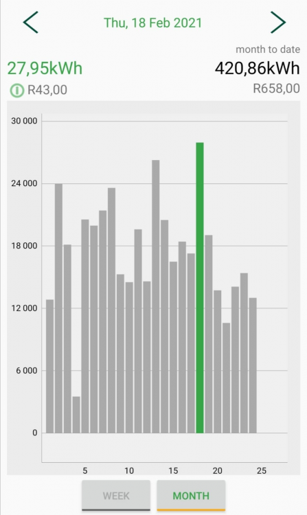

I am looking to tackle my geyser 1st however a few questions:
We have a smart geyser that allows me to set the max temp and track usage etc.
Question 1
- We average around R850 per month based on the app, however my full pre paid spend is never less than R2500/ month in Summer and+/- R5500/ in Winter.
- If the geyser is meant to be my largest entry spend monthly why is it so low relative to my boll?
- I'm assuming the scaling on the app uses uses a unit cost that is wrong (I cant change this)
- Does an average 545kWh usage make sense?

Does the graph only represent the use of your geyser and no other circuits? At what point are you measuring the use?
What did you use to measure this and get this information?
Agree that the rand values do not look right

Seems your geyser consumes around 20kWh's per day - which is fairly high for a single geyser. Does your smart geyser not allow you to set schedules?
You could recalculate your monthly cost for the geyser if you know your pre-paid rates, its definitely higher than what your app reports.

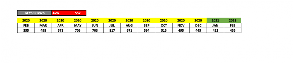

- I have pulled the data over the last year which shows an average usage of 557kWh per month.
- The geyser is set to run continuous
- The reason I have not set on/ off times, is I've read that it takes the same amount of energy to keep it hot over a period vs having it heat it from scratch at times

Q1 - your scaling may be wrong, but the numbers are way off. Either you are not measuring at the correct point (incoming from grid) or maybe you have a faulty meter or something else after the prepaid meter that is using electricity that you are not aware of. For R2500/month is over 1000kWh and R5500/month is over 2200kWh
I'm not following this statement- are you saying my consumption as a whole makes no sense as it is too high or too low?

Is the graph shown only the geyser usage?
Yes- this is just the geyser
This is just the geyser- with the sensor on the actual geyser- it comes to the senseable app.

5 minutes ago, Brani said:
Ok, I am sorry I misunderstood your original statement. You have already analyzed your geyser usage. If only one is powered, that is pretty high usage.
You can expect to drop that to about 100-150kWh (roughly) with heat pump.
What is your temperature settings? My heat pump is set to 55 degrees, and it's pretty good for the same size family
