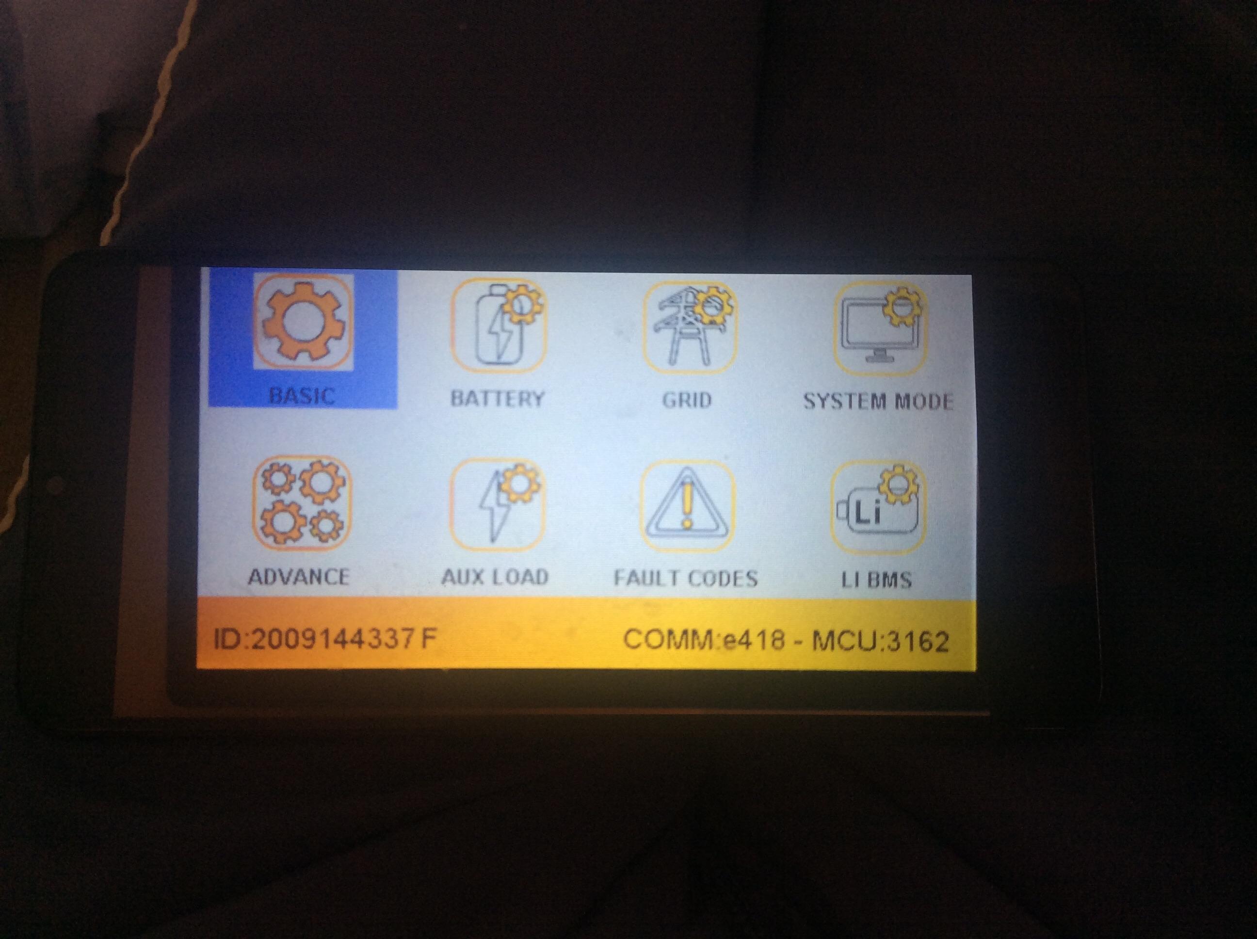

@branderplank, the 13 amps was confirmed by Sunsynk, I have a Sunsynk 5 kW with JaSolar 540 watt panels, Imp is 12.9 amps, had a firmware update done and see 12.4 amps regularly and even 12.9 amps once, briefly.
Which firmware version is that for the 5kW inverter?
