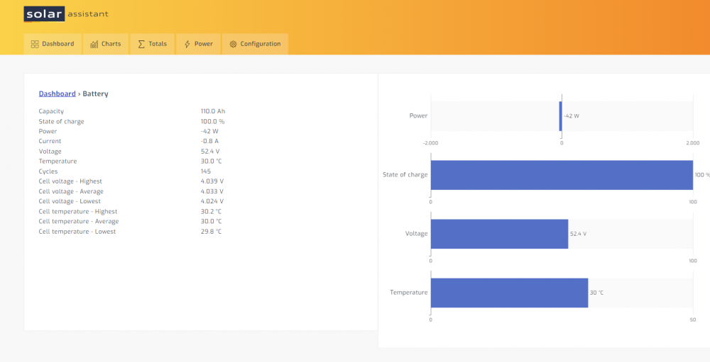

Nice to see your battery showing 110Ah Capacity on Solar-Assistant and after 148 "cycles".
This is what I expected.
For me the cycle count is ~1.3x higher than days.
110Ah is what I expected to give the 5.5kWh.
By AM-2 initially showed 110Ah, but lost capacity over time.
I charge to 100% using Solar during the day and down to 20% overnight.

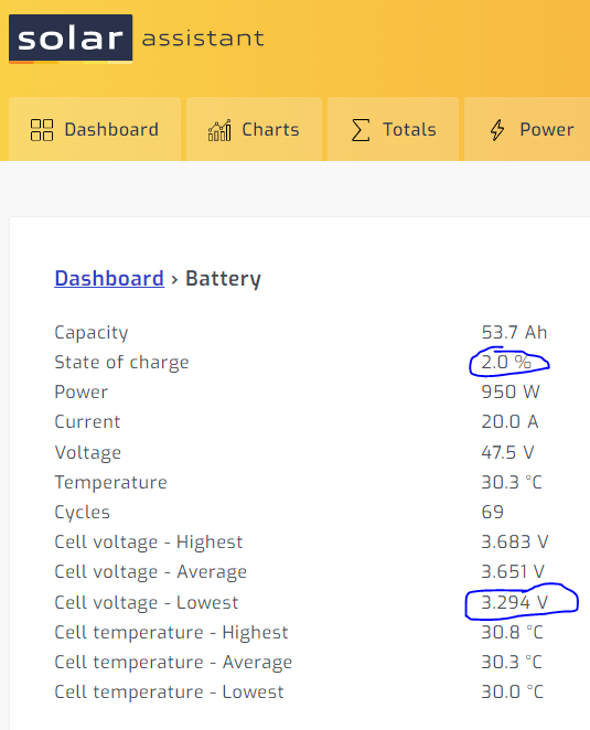

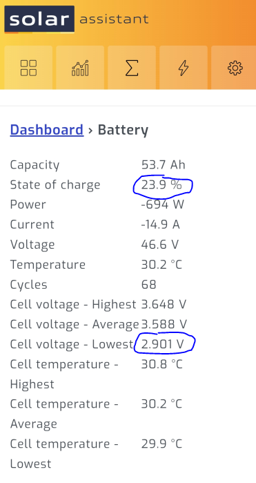

So, I'm busy cycling my battery again and this is a bit weird, or maybe I don't understand something.
On the left is today (now) and on the right is from Wednesday last week. At lower SoC %, the voltage is considerably higher today. How is that possible ?

I think the SOC reported by the BMS is a calculated value and not a measured value. If so, you can't really trust it. Anyway, I'm waiting for Hubble support to come back to me as there is clearly an issue. I told them I want to bring the battery in for them to test it properly, I'm not going to buy a cloudlink just for this.
