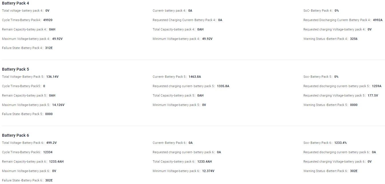

I've got an AM2 recently installed with a 2108x serial number. Solarman Smart is reporting some bizarre statistics for some non-existent battery packs (web UI screenshot below). Could this be caused by the same incompatibility between Sunsynk and Hubble? Or is this issue only related to multiple batteries and Cloudlink?
Firmware on the Sunsynk is a bit old and have posted similar question in the inverters forum here.
That crazy battery pack data seems to be a Solarman issue many people have including me.

On another note. I see my Libms menu shows SOH and see lots of others that does not? Is the SOH display newer firmware on the battery?
Which firmware version are you running? On mine, it showed SOH with older firmware but after an upgrade, it doesn’t anymore.
