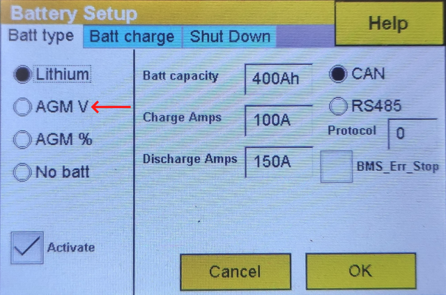

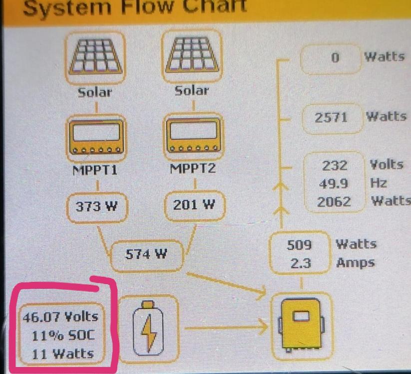

1 minute ago, system32 said:
Is your SunSynk 5k inverter set to AGM/V?
If the inverter is set to Lithium LiBMS, the value reported is from the Hubble BMS and not based on the Voltage.
My battery is set to agm-v

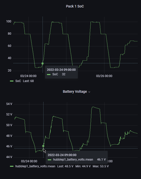

  • Update time.  Over the past week I've done a lot of monitoring and calculations to determine my capacity and to track down where the problem lies with my pack. The original problem I experienced
Sorry, I don't use SolarMan.
Not sure why SolarMan reports this.
Try disconnecting the CAN cable?
According to the Modbus documentation on SunSynk,
Address 183 is Battery Voltage
Address 184 is Battery SoC
Additionally, SynSynk has registers (values) for battery packs 1-15 in Address 500-809
Not sure if SolarMan is reporting on these packs.
EDIT: Check on the solarman website for the pack information

I've had my firmware updated and the the battery now refuses to go below 52% SOC.  This was the original issue, then it suddenly dropped to 0% and was erratic.  I basically have about 40% capacity in the battery after 7 months.
@HubbleLithiumPlease can you comment, as your batteries are failing left right and centre.
Have you tried setting your battery to Voltage (AGM-V) and not percentage ?

Some people have changed to AGM-V to workaround the SoC issue.
Im currently using AGM-V becuase of the SOC issue.
