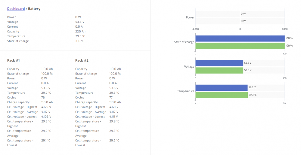

Like @YellowTapemeasure my 2x Hubbles have served me well. I feel for those with issues, but I treat my "twins" harshly during load-shedding when I know power should restore. The wife continues with the electric oven, and kettle too. Once load-shedding is over, I then treat the "twins" gently with a 40A recharge via Mains AC. If we are having a multiple day power outage, I ramp up the charge Amps for solar charging. So far the batteries and Inverter are a pleasure to have in these times of power failures. Below is the state of the batteries, as they have just charged after a bout of load-shedding.
Is this solar assistant?
2 hours ago, Leshen said:
Then your installer should send it in for testing and if there is a cell issue then Hubble will swap it out for a new battery. No need to wait if it’s determined that it’s output is only 2.2kwh
Will do this as soon as we are out of loadshedding ...

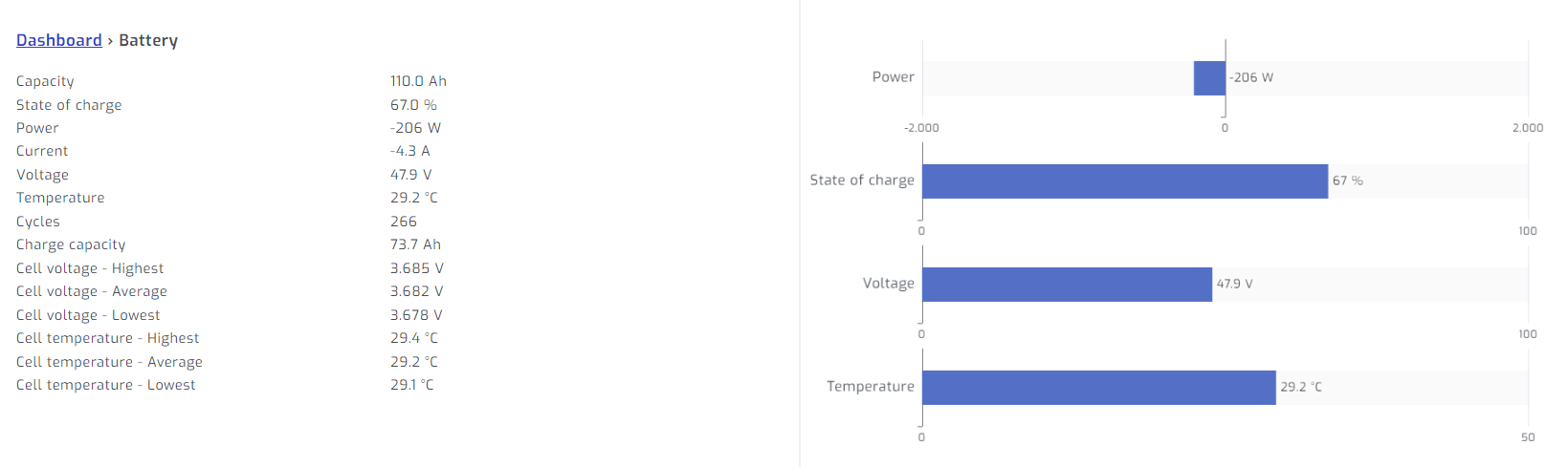

Just like yours, my single Hubble has had zero issue and still has it's 110Ah after 266 cycles.
Usually at between 30 and 40% in the morning before Solar recharge starts. This morning it was down to 28%.
No grid connection here. This snip is now at near 22:00
Edited by zsde
I have sometimes set the shutdown percentage to 10%, but have never reached this low, as the sun comes to the rescue, or power is restored. The lowest the batteries have gone too, that I can remember is 21%.
I see your night usage is very "efficient" at 206W. :)👍
It drops even lower after bed time :)
