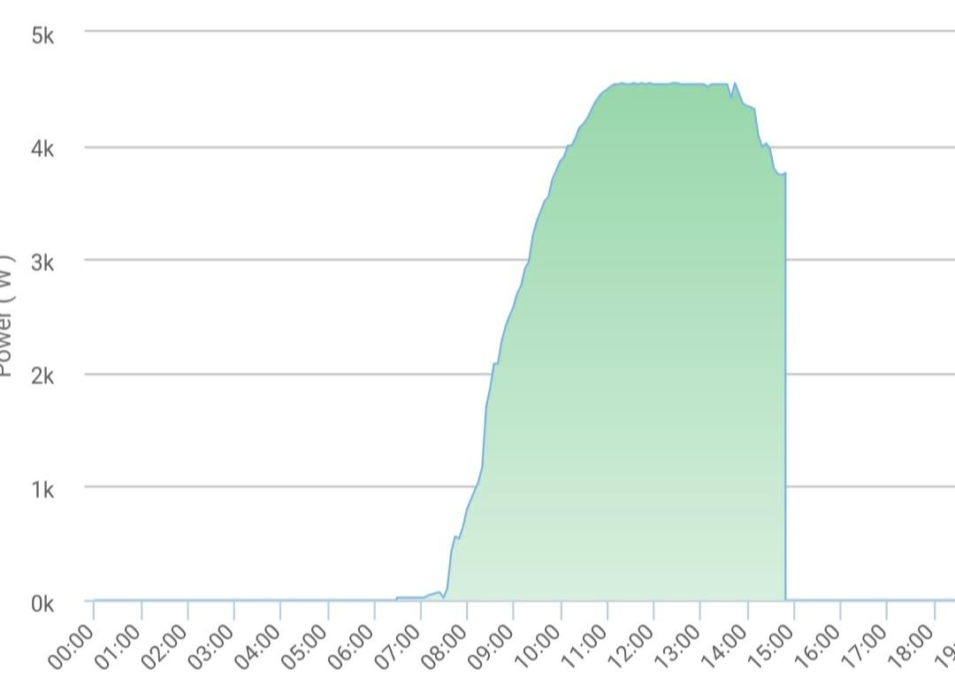

Here is a graph of my 5kw inverter working the most it has in one day ,you can see where it blends in from the grid.

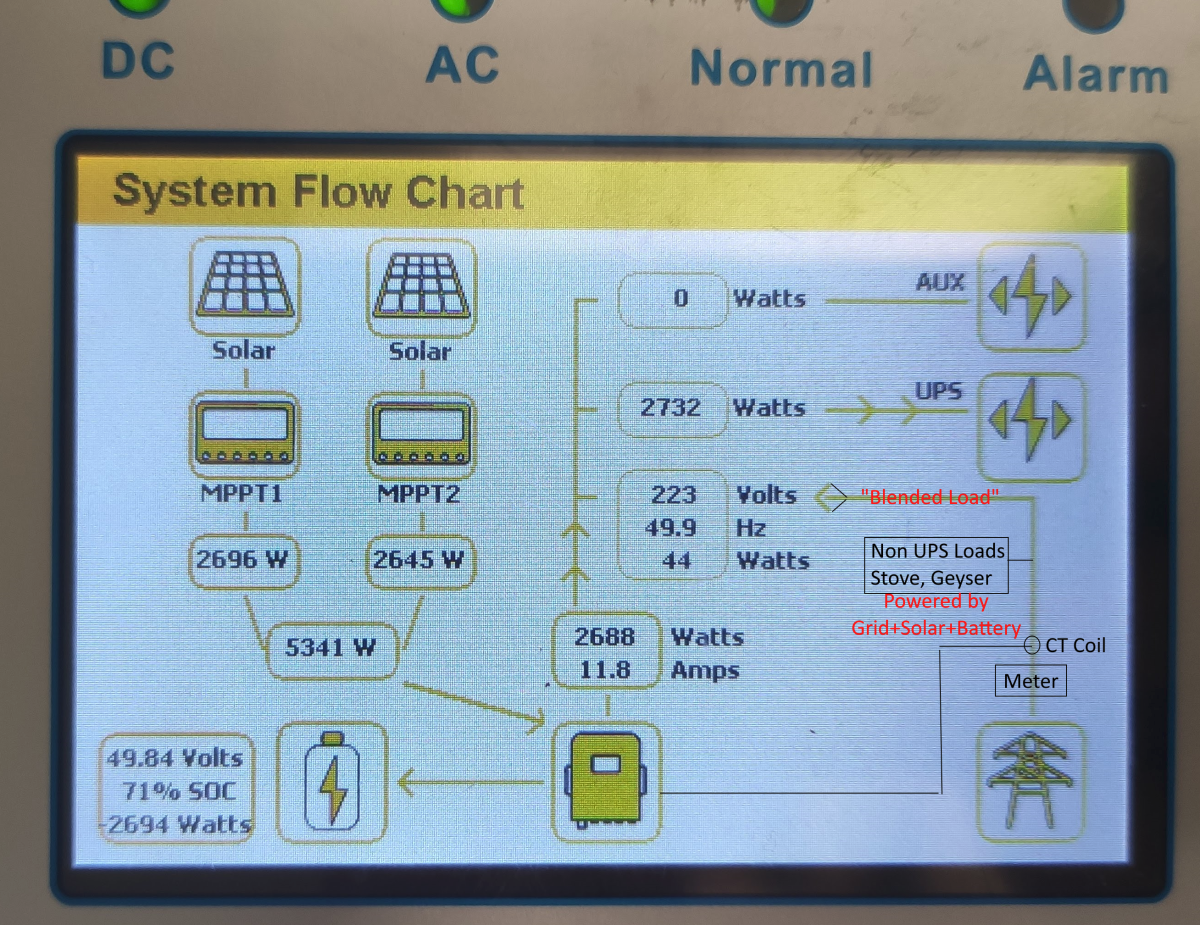

Remember that a grid tied / hybrid inverter can feed back to the grid.
If the load is in the "Grid" side, excess Solar capacity can be "blended" to the grid side to support a large load.
The 5kW inverter will allow a max of 5kW to be fed to the grid.
So 5kW from Solar + 3kW from Grid.

I'm glad someone gets this, and this is where my argument was. All those inverters that he mentioned, will trip if you go over their rated out put power
Because it is only a "Grid Tied" inverter, it should not trip if the load is greater than it's rated power. The excess that the load requires will be supplied by the grid(Eskom).
What it's rating means, is it can only supply 3kW into the load / grid.
The more advanced "Hybrid Parity (Super) Inverters" (SunSynk, etc) are two way inverters, with essential (UPS), non essential (grid tied), Aux ports,etc. These are in a different class, and more expensive.

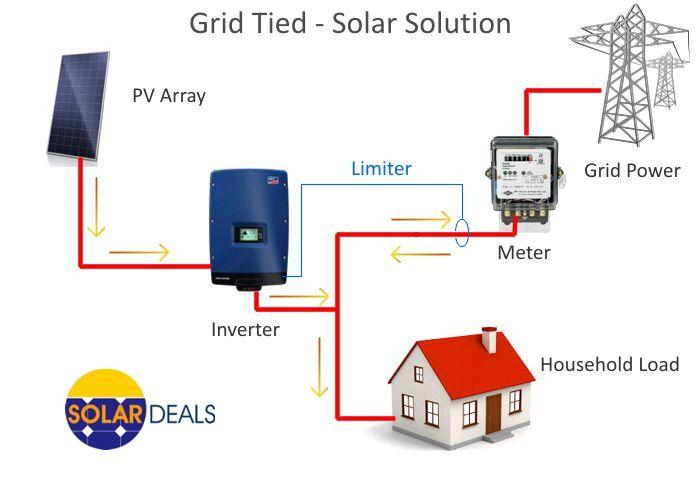

A grid-tied inverter does not have a UPS side.
The sunsynk 5kw can pass-through 35A, so yes, you can have 8kW connected to the UPS output without it tripping (as long as you have grid as well)
Grid tie is a cost effective solar system with no batteries and relatively simplified installation used in countries with a stable power utility to export power during the day, get credits, only to use them at night and thus have a net effect of a zero power bill.

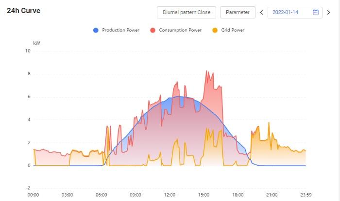

This shows how a grid tied does not trip when you have more panels than the output of some grid tied inverters. It will just clamp the output at the rating. 4.5kw in this case after 10h00. A great way of getting more power early and late in the day. My grid tied does not even have a overload to trip. If something goes wrong it will just switch off.

A 5kW inverter is rated to only CONVERT DC from panels to 5kW A/C...Its all about DC to AC conversion. How much the inverter can provide to load(+battery) may be higher than the rated DC to AC conversion rating.
E.g. my Goodwe is rated at 5kW, it regularly provides close to 6kW of power when it provides to my house and the battery (DC bus, DC to DC)...My entire house load + batteries can often get to 9kW when the kettle, drier etc. are all on at the same time...BUT, the inverter will still only CONVERT from PV to 5kW AC power.
So, to put it simply the rating of an inverter irrespective of batteries,  is what PV (DC) it can covert to AC...
And your panels should fit your Inverter (i.e choose inverter first) unless you have a restriction on space for panels (or panel capacity)...I'm not sure people buy panels first and then decide on the inverter to fit the panels!
