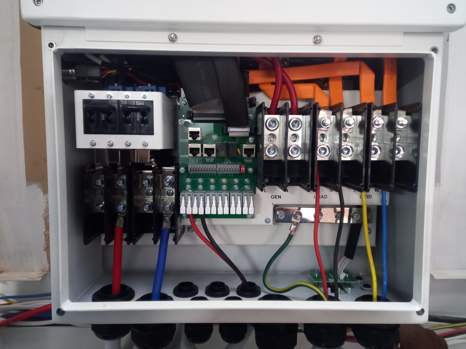

Here is a few pics I have from some installations.
Amazing thank you! Where does one get those auto-changeovers that are din-mounted from? Also what is Local Switch? Is that just overload protection for the EL? I also didn't know one could run a CBI Astute for the geyser without overload protection?

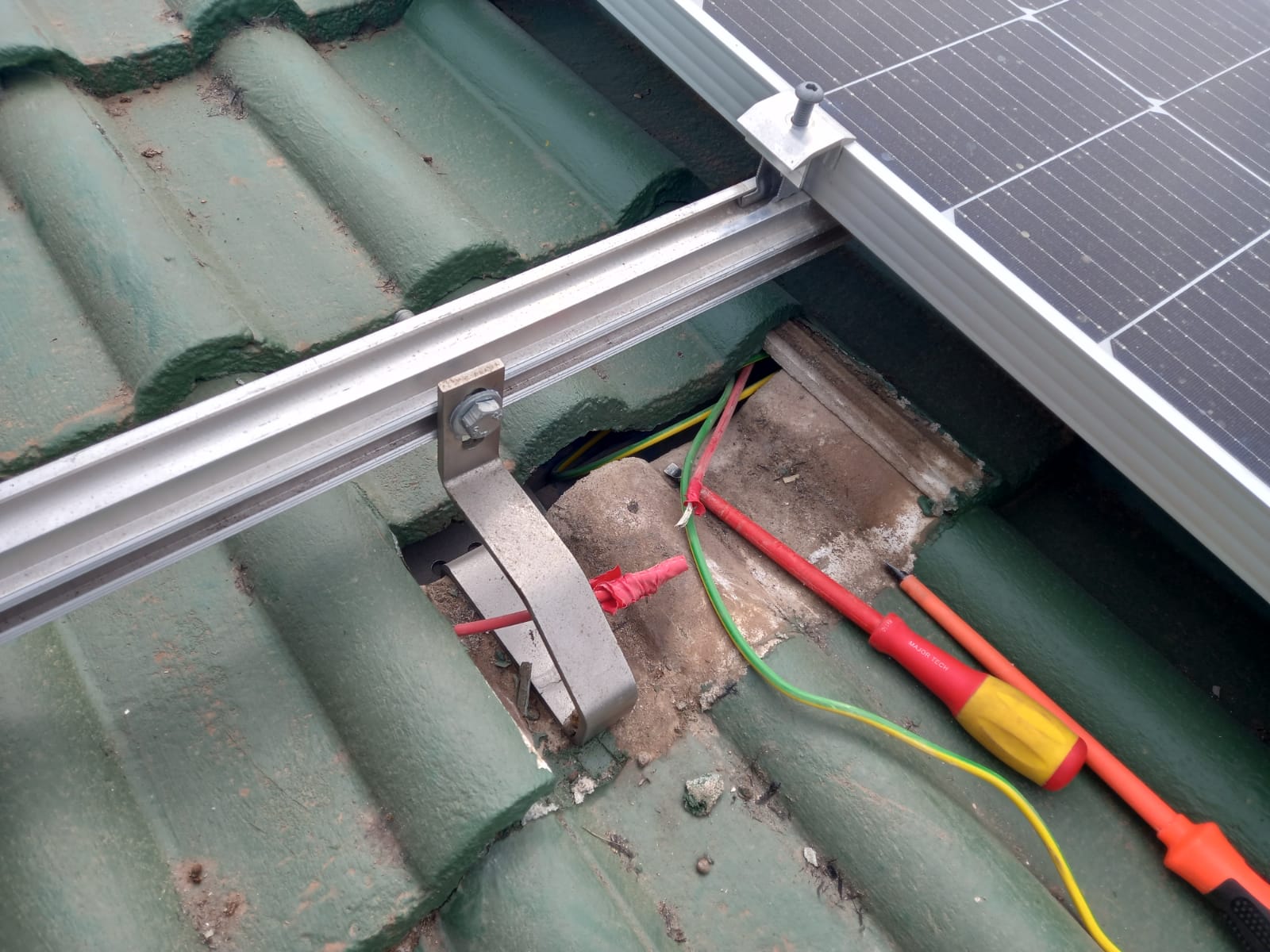

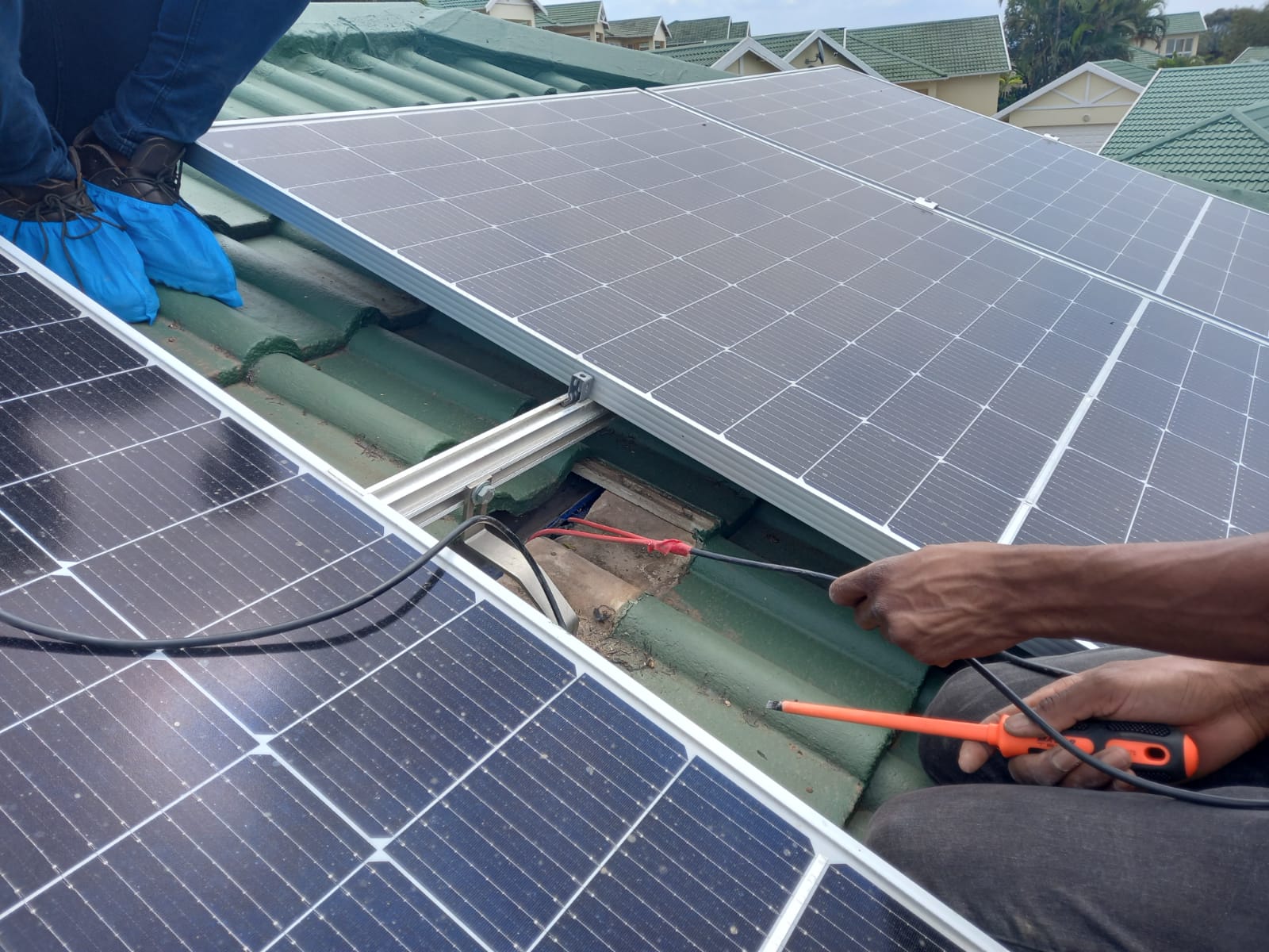

That’s what most people who speak this narrative don’t understand. Have a look at this 16kw Deye with 3 Hubble AM2s that was done cheaply.
6mm AC cabling on a 16k inverter.
25mm battery cable with a 125A fuse.
Inverter set at 250A charge and discharge from the batteries which eventually destroyed the fuses
PV wires in the roof joined as if it was cotton  MC4s cut off and wired twisted and insulated
Go cheap if you want. Just don’t complain afterwards
