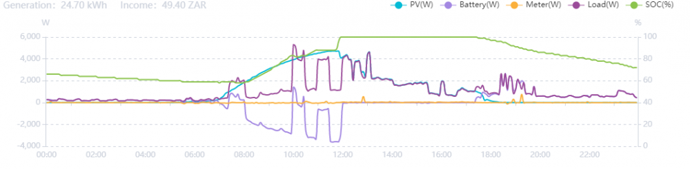

During summer the battery bank typically only drops to around 60% SOC by the time the sun rises and then is back at 100% by around 12h00 on a sunny day.
Summer plot
Winter plot (24% SOC on this day and just missed getting back to 100%)
I run the entire house (2x geysers, pool pump, fish pond pump, cooking (no gas), air conditioning units for heating & cooling the home (30000BTU total)) off of the PV and battery storage.
