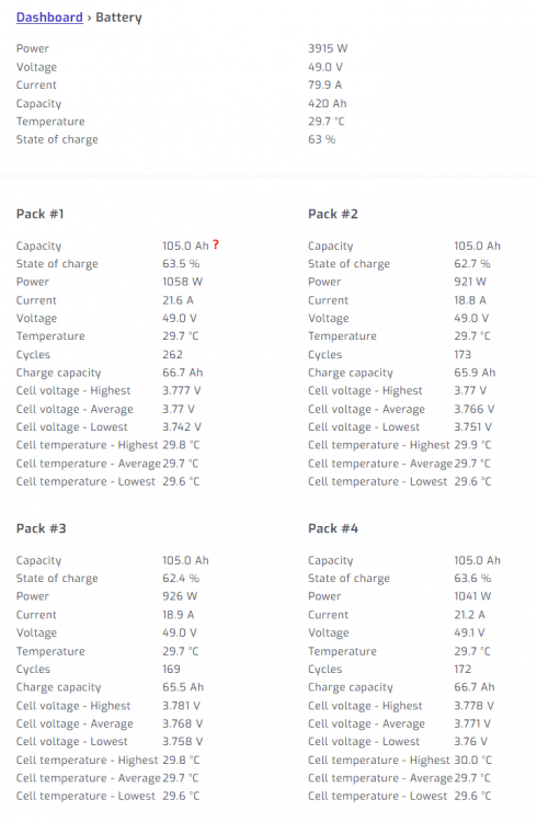

@system32Just a quick question. On SA is your "Pack #1" the master or slave battery? On my system Battery 1 is shown as "Pack #2".
Same here.
The pack order on SA using RS232/console is different from SA using RS485/modbus.
I notice that the battery temperature on the Dashboard > Inverter page is the correct value.

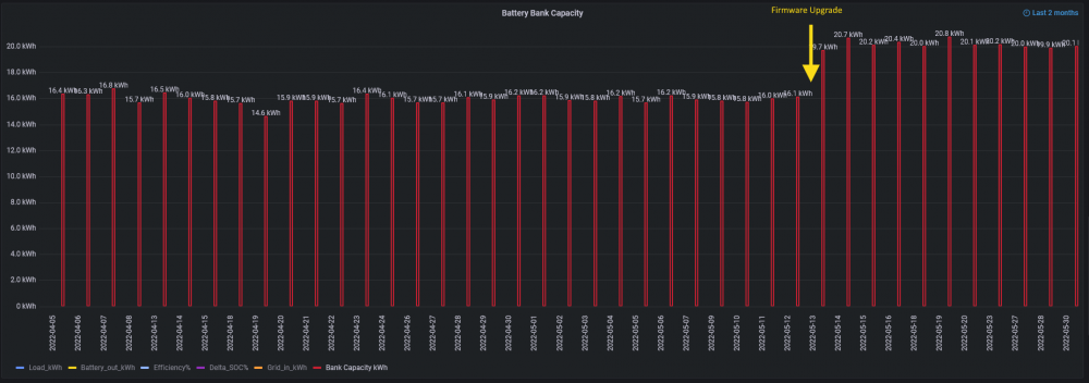

Update: 1 June 2022
It's been 2 weeks 3 days since I updated the firmware on the 4xAM-2.
So far all good.
SoH 100%🙂 and Capacity 105Ah😢 per battery.

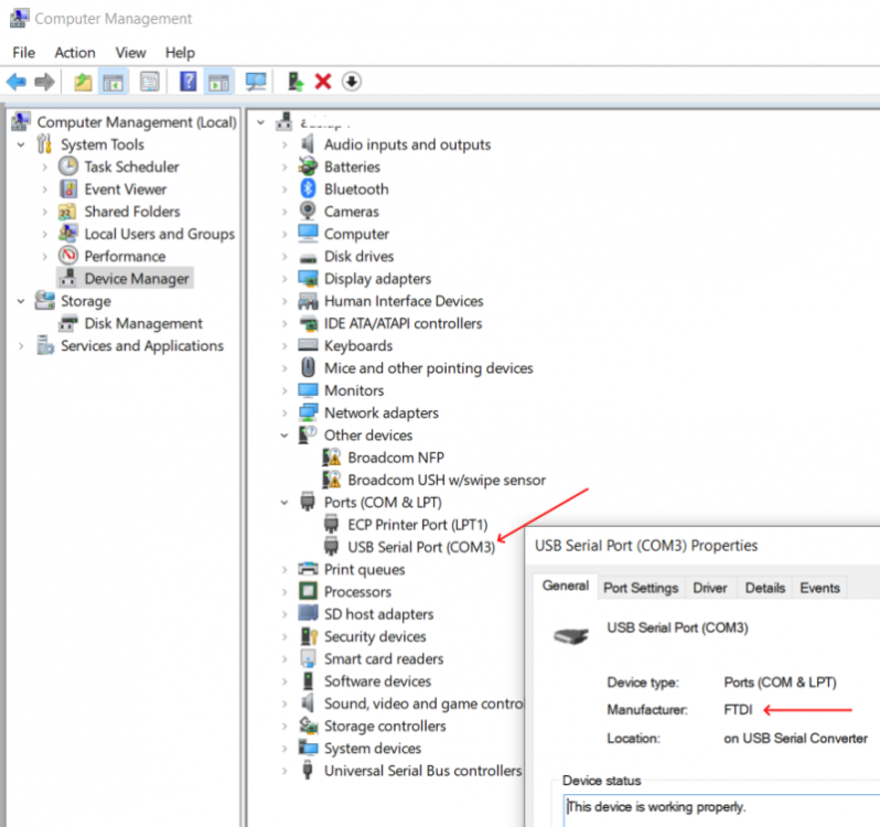

The firmware installation was done with with a Windows 10 laptop and USB/RS232/RJ10 console cable
https://solar-assistant.io/shop/products/hubble_am
EDIT: had to do a discharge to 20% and charge to 100% for reported SoC to match actual SoC.
Edited by system32

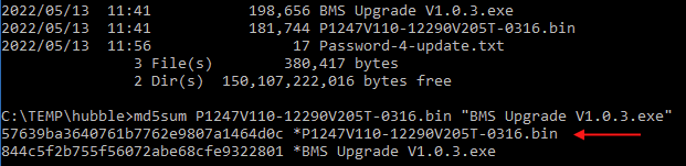

@system32 I got the firmware update utility and bin file (Same as yours) but i am getting a bin file error when I try to "Upgrade" I am using the usb to serial lead that works with Solar-Assistant. Setting appear to be set the same as in your screen shot.
Am I missing something? Does the AM2 have to be set into firmware update mode or something?
Did you put in the password?
Are you using the correct COM port? My laptop took a while to install the USB FTDI driver.
I just clicked browse, selected the bin file, entered the password and pressed upgrade.
I'll update the post with the MD5 checksum
Thanks for the reply.
Did all those things. Was using a borrowed laptop. Looks like I have to haul my desktop PC out to the garage and try again.
Checksum will be a big help. This is the MD5 of the file I downloaded.
57639ba3640761b7762e9807a1464d0c
MD5 checksum matches, so the bin file is not corrupted. Borrowed laptop had to be returned, but com port on my main PC matches yours, So will lug it out tomorrow and try again. Thanks for the info anyhow.
