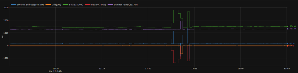

I have an 8kW. Using your formula it averages around 48W. It's evening now so no PV and the battery is discharging, load around 550W. FYI I'm not on the latest firmware
Here is another view. You can see how inverter power increases as the load increases. Load scale on the right.
Edited by slipx
