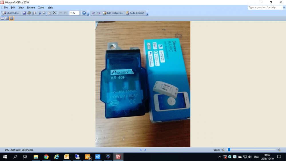

January 14, 20206 yr Author On 2019/10/10 at 6:09 AM, Quat Allah Al Shams said: I believe this is all you'll need. Bought from Communica fro my geysers Heya @Quat Allah Al Shams . Would you be able to provide the model number and brand of that unit you purchased with the sonoff. I would like to install the sonoff but I feel the inductive pool load will have its day with the poor sonoff. Please do let know. Sincerely Jason
January 14, 20206 yr Hi @Energy Its a AS-40F and Asiaon 40A 250VAC Power Relay Hope drawing makes sense (for geyser connection) https://www.communica.co.za/products/jqx40f-1z-ac240v Edited January 14, 20206 yr by Quat Allah Al Shams url for product at communica
January 14, 20206 yr Author Perfect Sense. I am looking for a DIN rail version of your exact one. I really appreciate the sketch! Max points! I am struggling to find a store that stocks your one. Sincerely Jay
