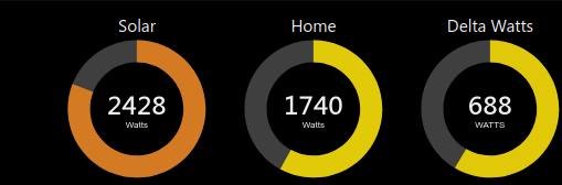

Realized the whole week that my panels were only producing 2.1kw (2.4ish) system. (10:40 in the morning) Well, I thought, it's winter and this should be expected. But anyhow, I climbed on the roof and saw a thin layer of dust. Cleaned them using the sponge side of a squeegee and a bit of running water. Got off the roof and immediately saw a jump to 2.4kw . That's an immediate gain of about 300w. Where I live, although on a farm, there's still a lot of mining dust blowing the whole place full. When I was in town, this was a weekly occurrence.
About using soap, Imo don't, just use clean water. If you don't get all the soap off, there will be a sticky residue enabling the dust to stick to it. Got this info on google.
Anti-reflective (AR) coating: An anti-reflective coating for solar panels is a nano coating which reduces the reflection and glare produced by an uncoated solar panel. It does this by reducing the difference in refractive index between air and glass.
Soap will remove this protective layer over time, unless it's specially made for this type of cleaning. (I think)
....and this is about half an hour later. Thought it was the cooling effect of the water, but seems to be stable.

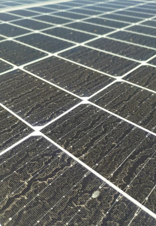

My panels look like this 1 week after cleaning.... I am not exactly spiderman and my neighbours are going to think I have gone OCD mad if I jump up and down my roof on a weekly basis. So isn't there a more sustainable solution?
Has anyone tried these so called nano ceramic coatings? The information and company details behind these products look a little bit sketchy so I am not sure if it is just a money making gimmick? Kind of makes me think the salesmen behind these proliferate car detailing products which are being hawked at filling stations have simply relabeled some of their product lines as PV coatings.  Nevertheless, hoping there is a real McCoy out there someone can recommend
