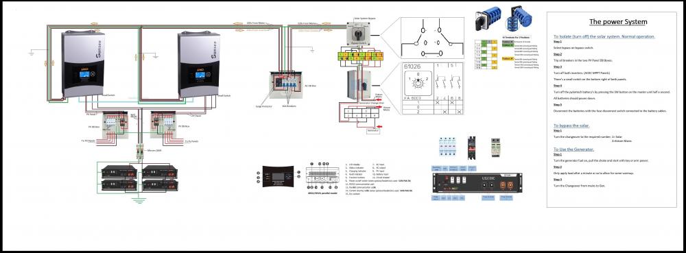

19 hours ago, Piper said:
So the plan is to be able to use as little Eskom power as possible but to stay connected for in-case.
At this stage I instaled the inverters ,some db boxes and so on.
Below the plan.(feel free to comment or give advise)

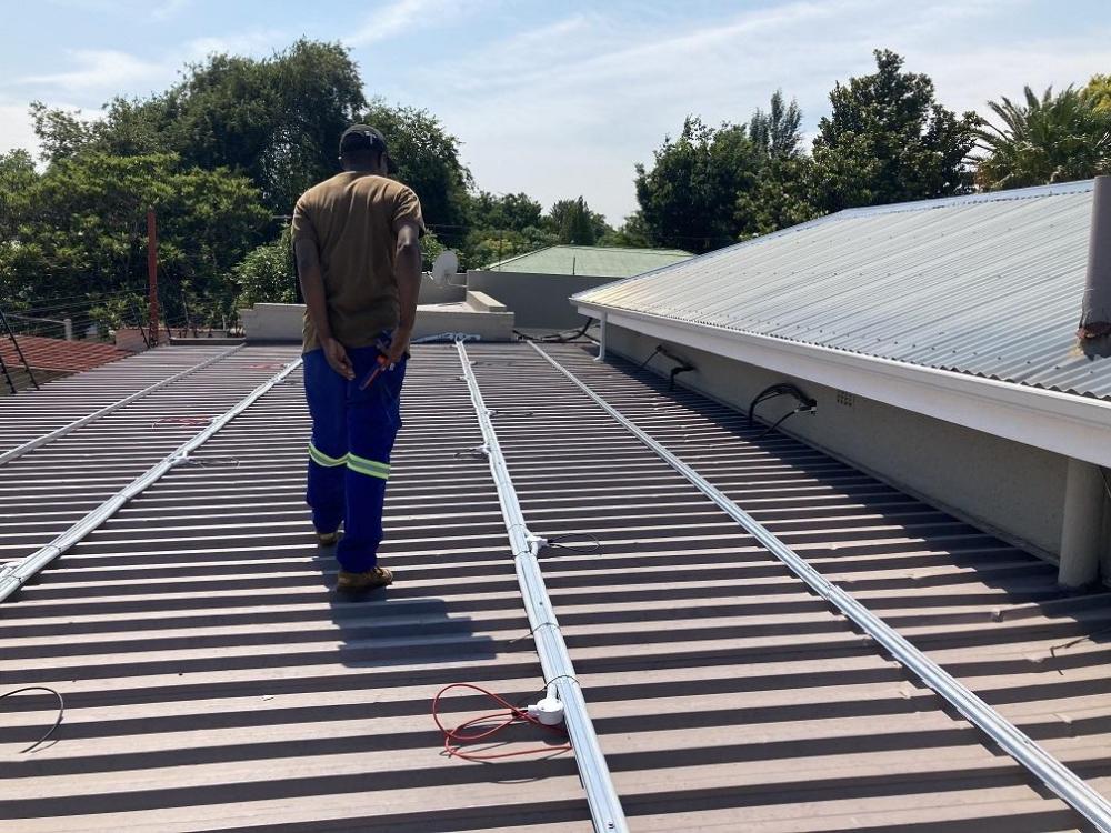

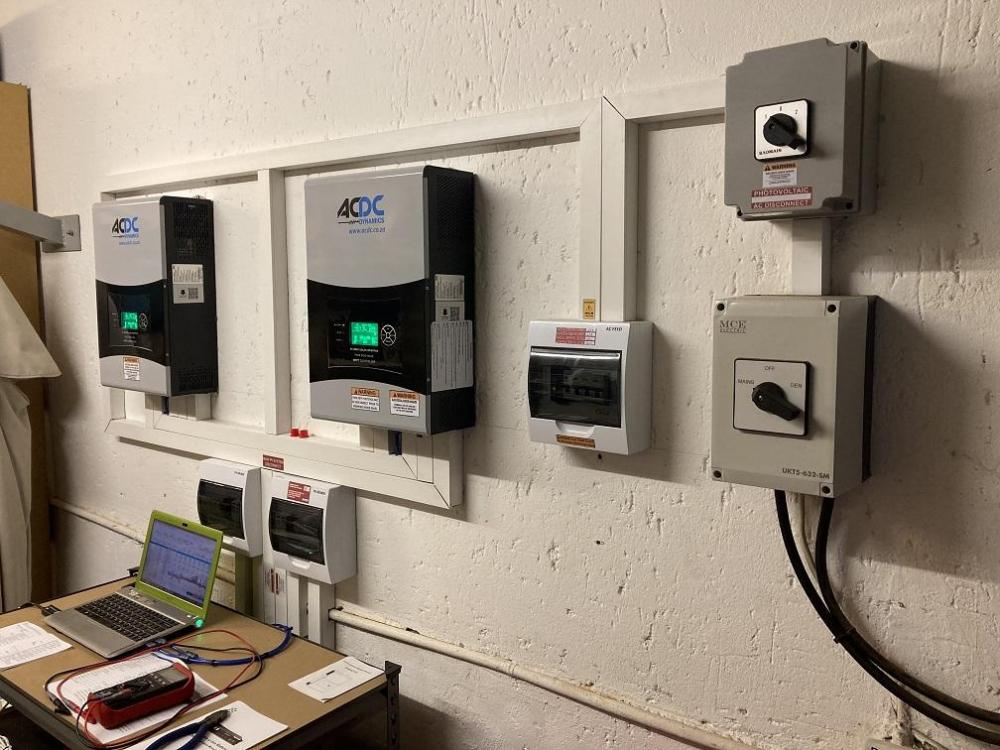

Time for an update.
Panels installed all hooked up and currently testing.
Ran into a snag trying to get a COC. Everyone closing for Dec or finishing final jobs for the year.

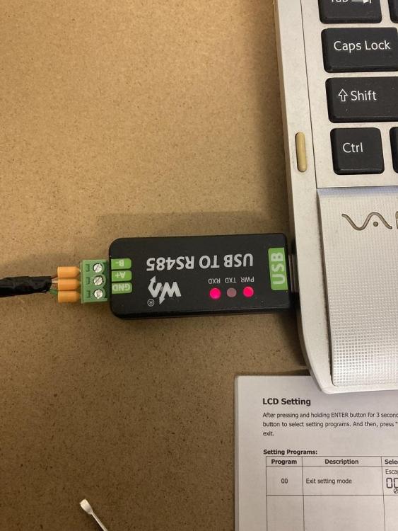

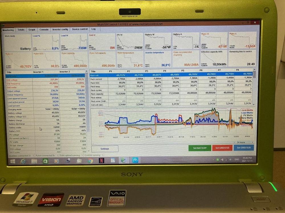

As you can see I'm using multisibcontrol via 2 usb cables and the little usb to rs485 converter.
Mounted the rails directly to the IBR roof with some good old tex screws.

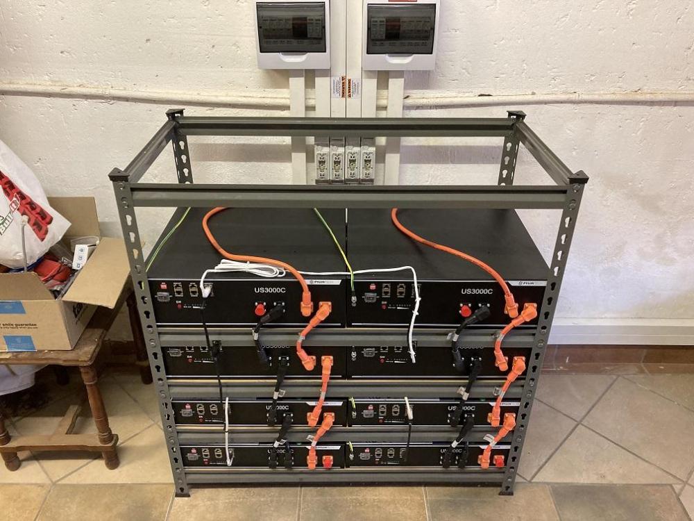

Batterys on a boltless shelf.
All the pv cables in flex conduit and kept it simple .(+ with +) and (- with -).
