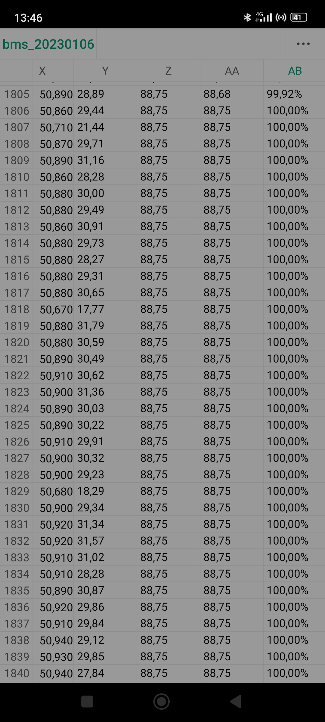

Well, looks like I have the same issue after all with my Deye + Narada with the infamous Shinwa BMS : SOC reported by BMS doesn't make much sense. Battery reaches LV disconnect with a SOC of 60% and they are nowhere near full charge when reaching 100% SOC. Less than 50v @ 100% & they keep taking 40A for a while before reaching 51v. Like twice the amount of  time they need to go from 80% to 100% at constant 40A. SOC would probably be displayed as 150% to reach full charge if it was not stuck at 100% ...
Switching to voltage.
A shame after spending so much time to figure out proper com between Deye / Sunsynk & Narada 🙈
Have you tried voltage settings while at home to see how that would charge the battery?
It does charge until 51v ... Which is probably something like 150% SOC according to the BMS 🥳
Will check what BMS says about individual cell voltages using the BMS software ...
Here are the funny logs when charging with communication disabled.
100% SOC @ 50.860v with 30A all the way to still less than 51v and a SOC still displayed as 100% when getting 30A for 20 minutes ...
Actually looks even worst : battery charged well above the 100% SOC, taking the 30A current all the way to 51.5v for like 30 minutes past the 100% mark. Was expecting that surplus not displayed to be stored somewhere but SOC decreases as soon as battery discharges.
Now trying to discharge down to 43.2v (Low Voltage Load Disconnect as per Narada specs ...) to see what SOC I get ...
