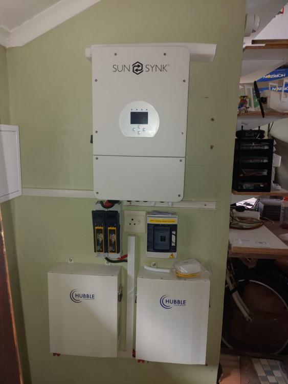

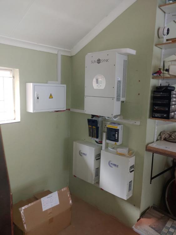

13 hours ago, Brani said:
Looks stunning.
