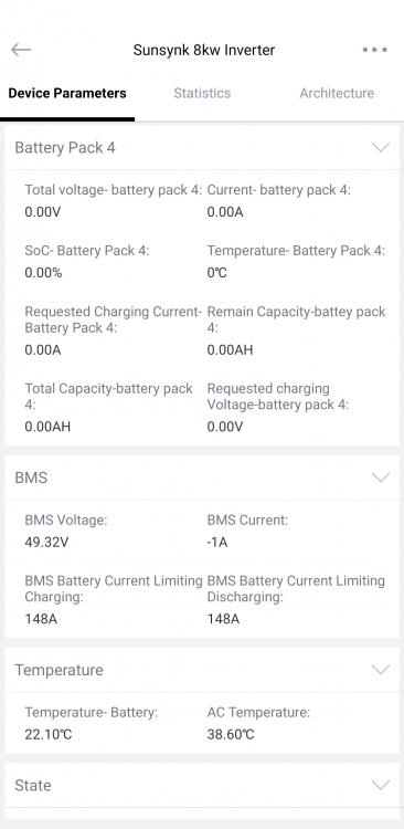

I am using SM Home on my Sunsynk inverter and the battery info is not correctly displayed.  For instance, my comms between the batteries and inverter is correct and its controlled as expected but on the solarman app i only see 1 battery (i have 2) and the temp shows 100C which is definately not the case...
What battery do you have?
I have 4 pylontechs and it doesn't read the individual batteries but the data from the BMS.
First pic is from Solarman Business and second one from Solarman Smart. I alternate between these two and even though I have pro and home versions I don't use them.

Thanks. I have 2 Lithium Batteries SA 5.2kW batteries. So far they are performing great and the price/kWh was also very good.
