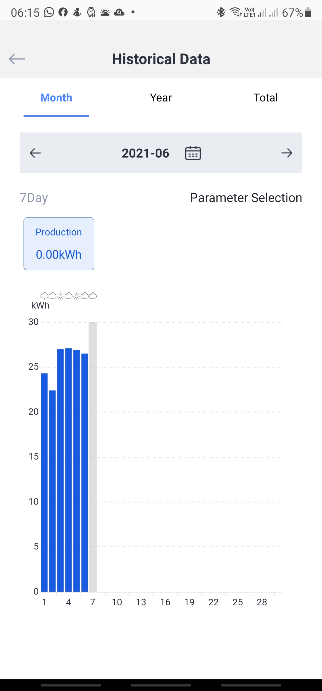

On 2021/06/08 at 10:18 AM, Achmat said:
Yesterday's data seems to be completely missing from the monthly graph even though its there in the daily graph. First time this has happened. It shows zero production or consumption for yesterday.
How did you get it resolved.
I had the same issue. Also, my system shows partially down at aroind the same time everyday. I reported this is Sunsynk advised me that it is likely a solarman issue.
Mine was a Solarman issue that Solarman resolved. The pv production for the missing day but all other data like consumption battery charge and discharge totals are missing.
I used the app chat feature on Solarman Smart.
Edited by Achmat
