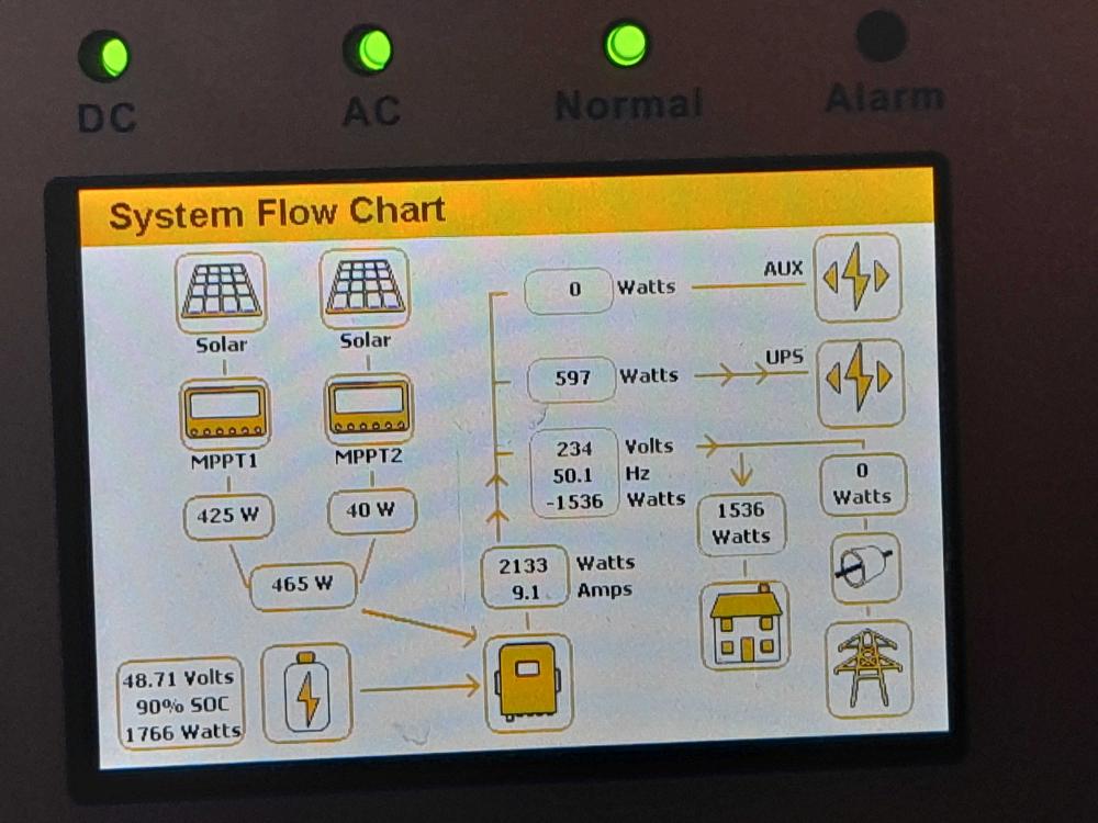

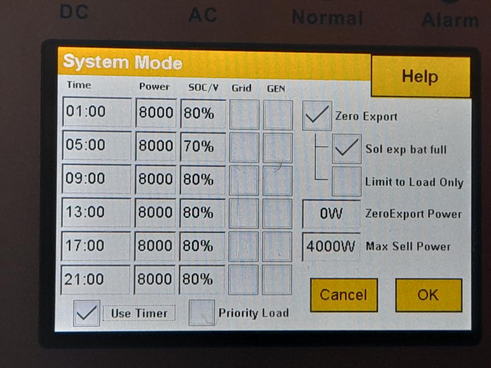

Here are some pics I took yesterday afternoon.  So the essentials are pulling 597 W20210318_171555.thumb.jpg.ad0df5c457c00d75d08de321da69e4d0.jpg
The battery is delivering 1766W
The sun is giving 465
1536W is dumped to the non essentials which were disconnected at the time.
The CT clamp is around the incoming red wire which I suppose is live.
Regards
Attie

42 minutes ago, Attie Jonker said:
HI Guys
Thanks for all the replies.
Regards
Attie
Why do you have solar export battery full ticked?
Is the CT on the red incoming wire at the inverter or at the electricity meter? It should be at the meter.
Looks like an installation wiring problem.
Remove the tick from solar export battery full and see what switches off.
Other issue could be that the internal CT sensors are faulty.
HI Guys
The solar export tick makes no difference.  I have tried just about everything.
I have not installed this one myself, but did the previous one. So I can remove stuff and test.
By isolating the non essentials, I opened their breakers, so they are physically not in the circuit.
Attie
Im having a similar issue.
It only supplies the grid side when 'limit to load is ticked'??
Wondering if this might be a faulty inverter? But I'm trying to rule ever out first.
