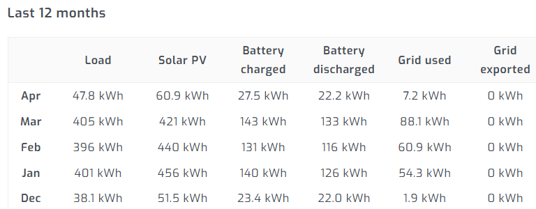

System commissioned in December 2024.
5kw Luxpower SNA5000
1 x 5.1kw battery
8 x JA Solar 600w panels
Geyser is solar and have not run element since November
My grid use can be attributed to not having sufficient storage, I need 1 more battery at a minimum to get my grid use down:
Overall, since installing, I've saved R3700, averaging R1100 per month saving. This could be up to R1400 with an additional battery.
At the current price of electricity and my usage / generation, my ROI is +- 4.5 years as my system, fitted, with COC, wiring, engineer report, registration, etc, cost me R55000

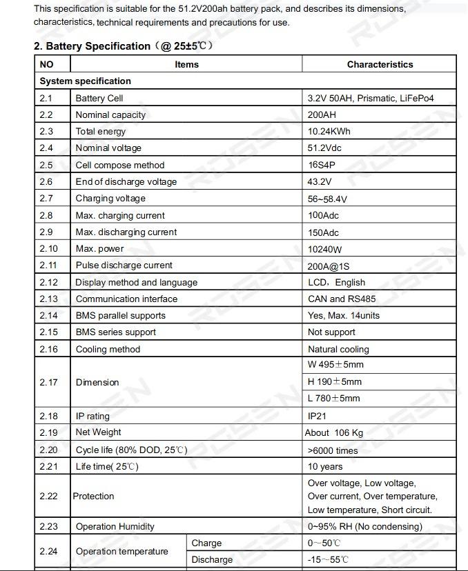

On 2025/04/12 at 4:24 PM, chrisc said:
Friend in Somerset West bought this one in November 2024 and it behaves well
Is there any link where one can view the user/tech manual for these batteries?
What BMS do they use? Would be great to check the protocols and interface for the differing Inverters that they claim are compatible.
Can you check with your friend if he received a comprehensive manual with the battery and if there is perhaps a link to an online version?
So I did find a manual online. Irritating as you have to wait for an ad to open the next page, but at least it gave me some insight. So these 200Ah batteries seem have 64 X 50Ah cells in a 16S4P config. Never seen that before in a off the shelf battery.
https://www.scribd.com/document/663207328/Rosen-51-2V-200AH-LiFePo4-Battery-Powerwall

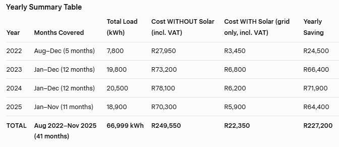

My systems performance so far:
Assuming I sale R1100 this month and R1100 next month, my average monthly saving would be at R930.
I've since installed a 2nd battery in July which brought down my grid usage considerably. At this rate, ROI is 6.93 years.
I have done some changes since my last posting here which has taken my final install cost to R77285.40incl for the inverter, 8 panels and 2 batteries, with hook up which I've already used
For the past year I have saved a total of R83k on my Tshwane Electricity bill, now if they had a better incentive to push back to the grid the savings would be much better. total since installing the system in 2022 I have saved almost R230k so next year the system would be paid off.
Edited by fstofberg
Thanks for the detail figures provided. You have one of the most effective systems from a ROI point of view around. Most have a pay back term around 7 years for a battery system. Performance is remarkable.
