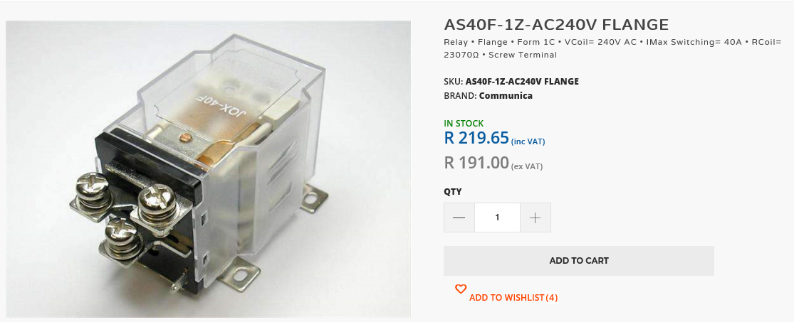

I found a 12 amp relay, would  a Sonoff Basic hooked to the 12 amp relay be ok for a 2 kW geyser, ie 9 amps.
It will work, one thing to keep in mind is every time it switches on their is a small spark that switching spark is a big contributor to what eventually destroy’s the contact, the bigger that contact the longer it normally last. I would rather install a relay with at least double the load current rating to get a longer life out of the relay.
If you have a look at the Amp rating of your Geyser's Circuit Breaker in the db you'll see it's at least 20 Amp, if not 30 Amp so a Power Relay like this, switched on/off by the Sonoff BASICR3 for instance (using 220V to drive the VCoil,  is, I would suggest a minimum requirement. image.thumb.png.2a3ce9db8401dfdc27128b6e6d50353a.png
Although I'd prefer a 3P Contactor to switch Live and Neutral.
