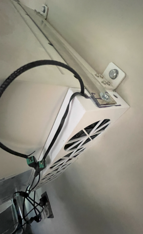

This is mine. Just took a piece of alu flat bar and bent the one end 90 degrees and bolted the other end at the fan side to the 3d printed fad mod. So it just hooks over the inverter.
Both temps dropped by between 10-15 degrees. My ambient temp in the garage never goes above 15 degrees.
