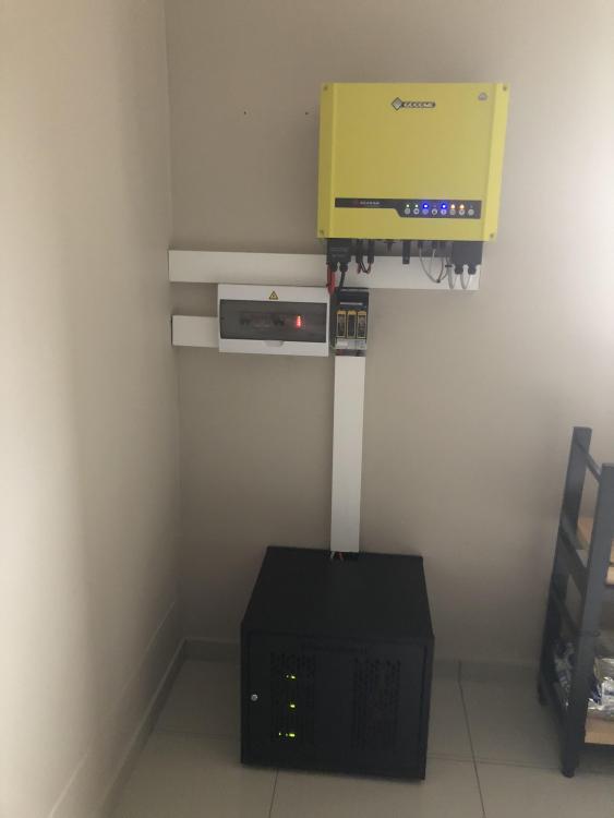

Not only that, when they are stacked in a rack or on the brackets and connected, they look so attractive and neat. Makes any installation look tops, no one worries about the internal look. Pylons for me, any day any time

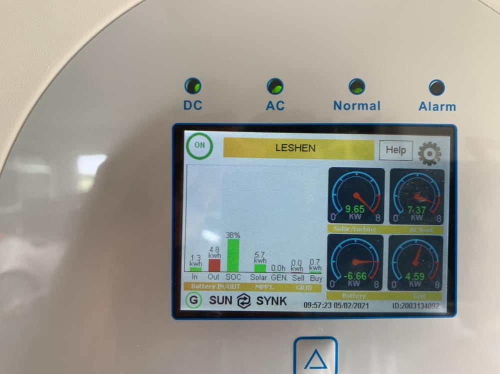

I prefer either Hubble or Bull.
Your BMS is correct regarding 111A as you have 3 x 3.5kwh Pylontechs (I stand corrected). That’s a total of 10.5kwh yet you can only use 5.3kw at any given time from those batteries. Take just 2 x 5.5 Hubble batteries and you can draw 200A which is almost double. The Bull battery can deliver 210A from 2 x 5.1kwh. It won’t matter on a 5kw inverter however when an 8kw Sunsynk needs more than what the battery can deliver, and yes it does happen, then the Pylontechs do not deliver when the same size battery bank is used compared to a Hubble or Bull.
The pic below shows 6660kw being delivered to the batteries at 130A with 2 x 5.1kwh Bull batteries. Your 3 x 3.5kwh Pylontechs simply cannot do that.
Please note that I have had Pylontechs in the past so I’m familiar with all three brands.

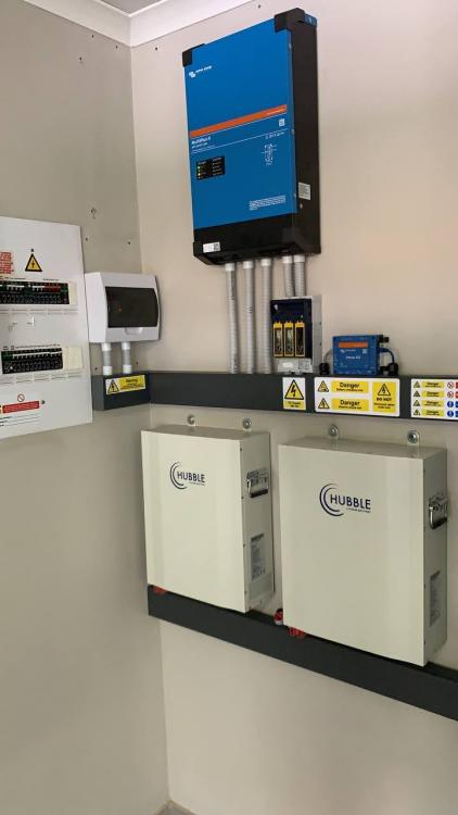

Hubble vs Pylontech  AB9008EC-0C27-4B67-8941-B426950D4556.thumb.jpeg.d0b8c379e955998c2a4d00a27f8a87a9.jpeg7F4D0113-4AA3-4CC3-8C58-F46145255FE8.thumb.jpeg.d1c6105b171cf27f529d1e8caf84c77a.jpeg
