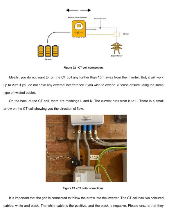

The information using letters K and L as well as the arrow is quite clear for me how it must be installed. From the manual. IMG_20220601_221431.thumb.jpg.9e1276f13ec52ef5299ab1adaf18d854.jpg

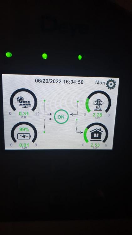

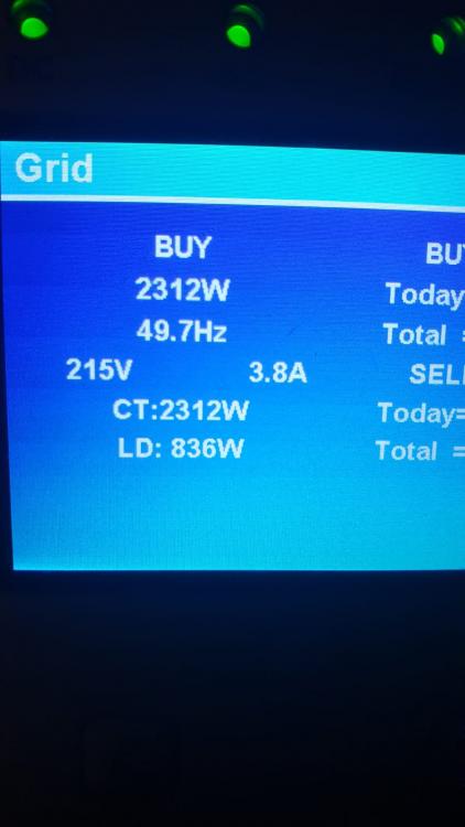

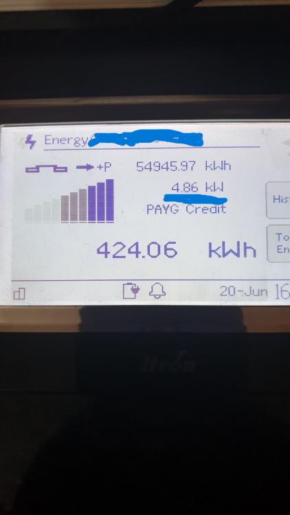

Hi I suspect my CT is not installed correctly. My prepaid meter shows the correct grid usage, but the inverter (and SolarAssistant app) shows the incorrect readings. If you add Grid + Load it equals the correct figure for actual grid usage. In my mind the Grid usage should be = Load - Solar production? At the moment my grid usage readings are only about half of the actual usage. Anyone got a solution to this?
